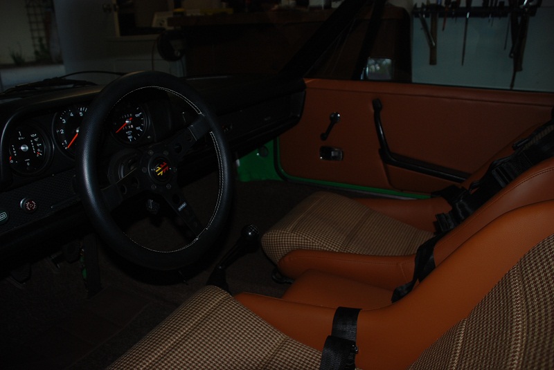

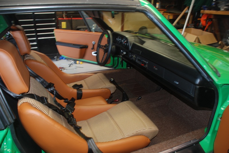

proto31   Installed all the carpet, had to remove the steeri...   Mar 20 2011, 09:14 PM
proto31   Thanks for the comments! Here's the inte...   Mar 20 2011, 09:17 PM
