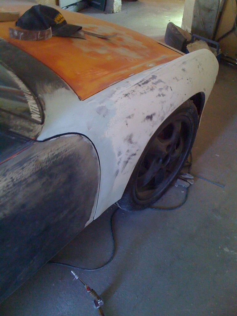

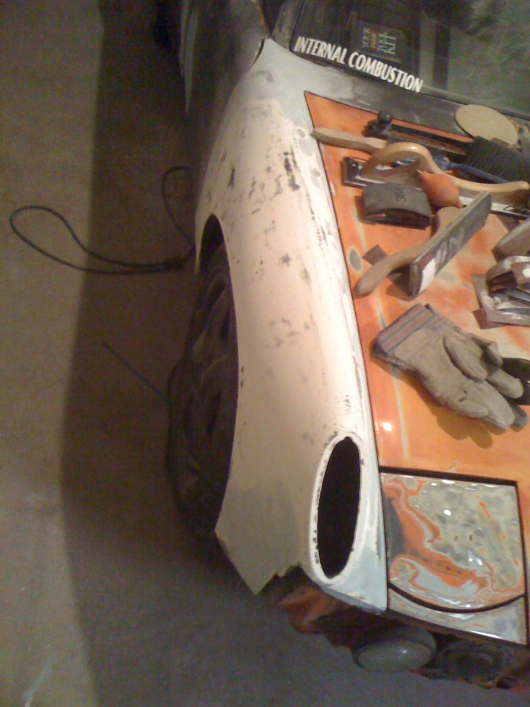

Got some mixed progress done tonight.

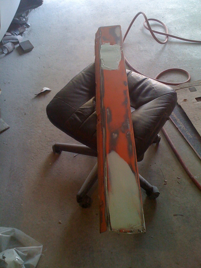

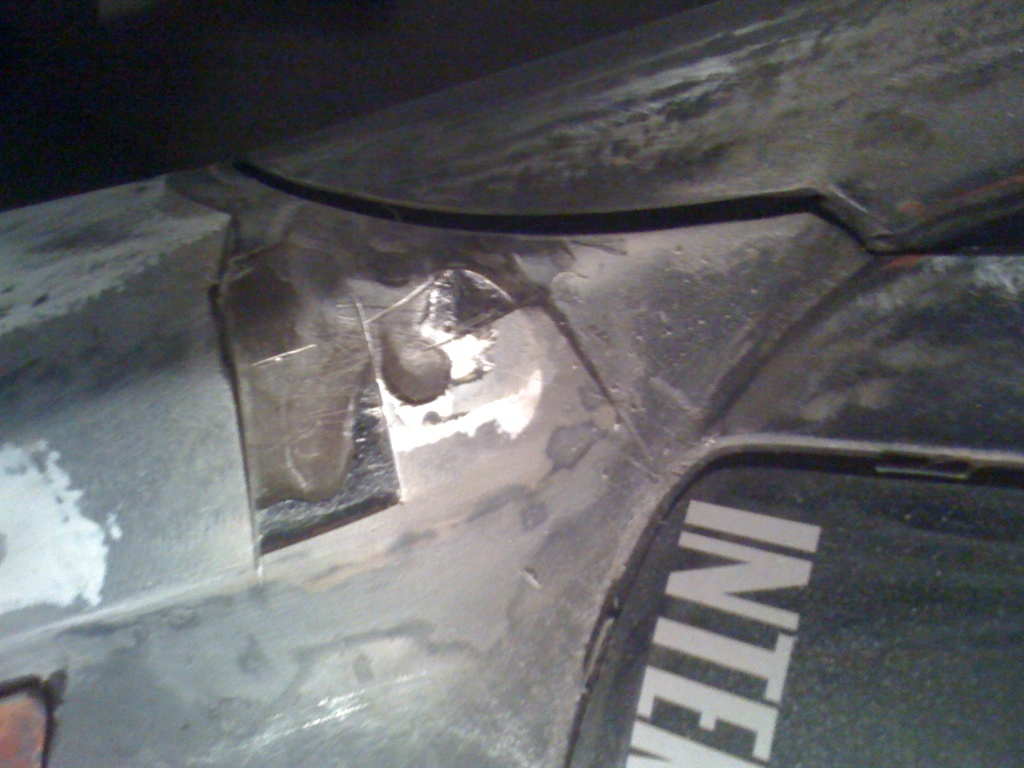

Finished grinding the targa bar down, but I still have to weld about 1/3 of it back up and I FINALLY have my welder back.. Arg. (My friend used up 3/4 of a 2lb spool of wire.. bought me a new spool though)
My friends Geo... (Orange914's son)

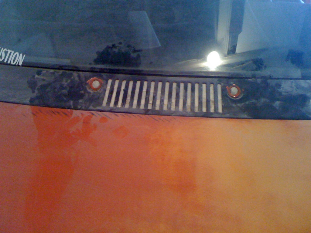

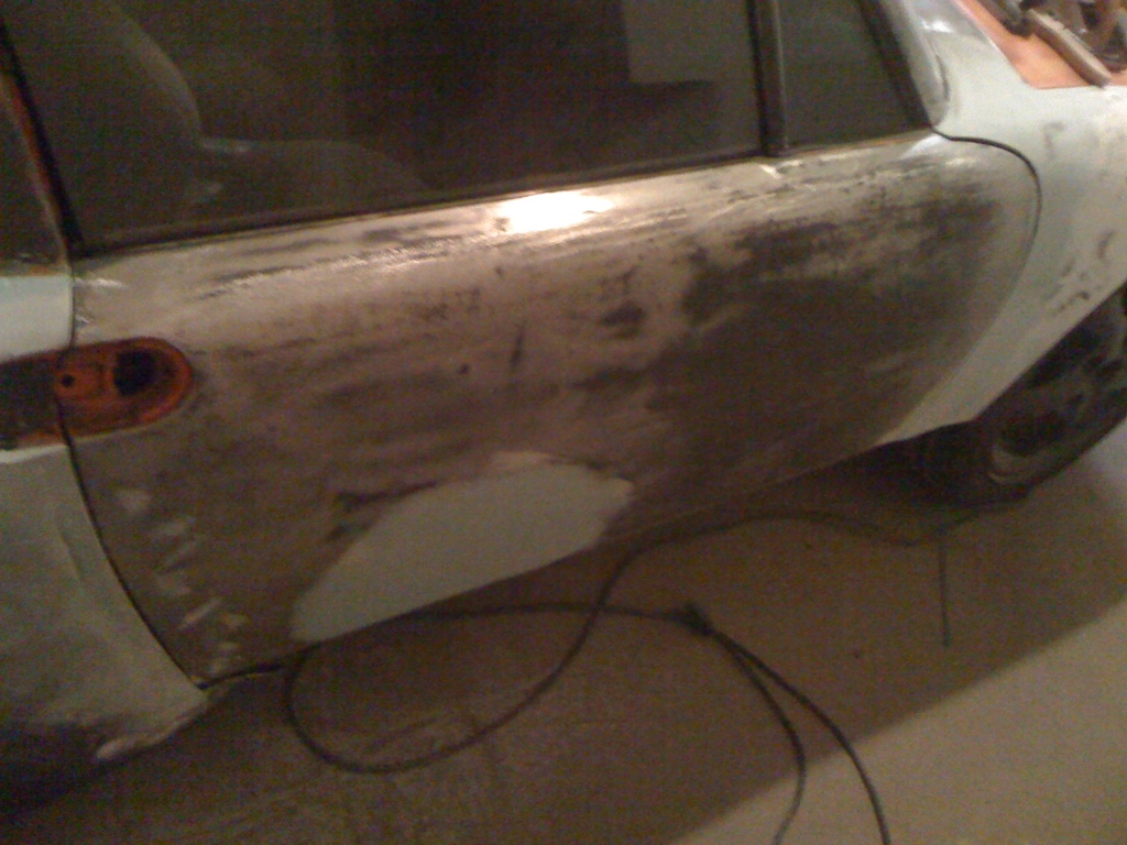

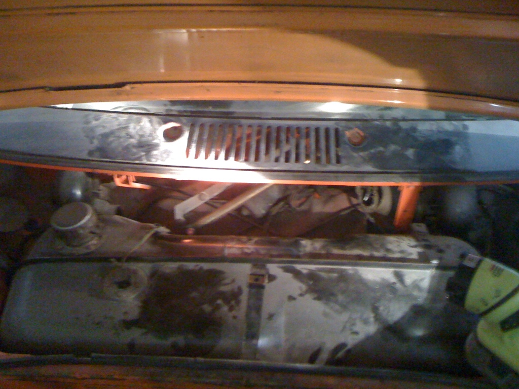

Pulled the windshield wiper setup out. Figured out the trick to this which no one mentioned on any of the posts I found. Obviously there is the 3 bolts (two up top on the cowl, one behind the speedo to the right), but you have to remove the rubber grommets on the top as well with a knife. THEN you basically force the passenger side upper bolt out and pulling it down removes the back bolt and then the right side bolt can come undone. Once I figured this out it was a 1 minute job (however it had me scratching my head and looking up posts for an hour).

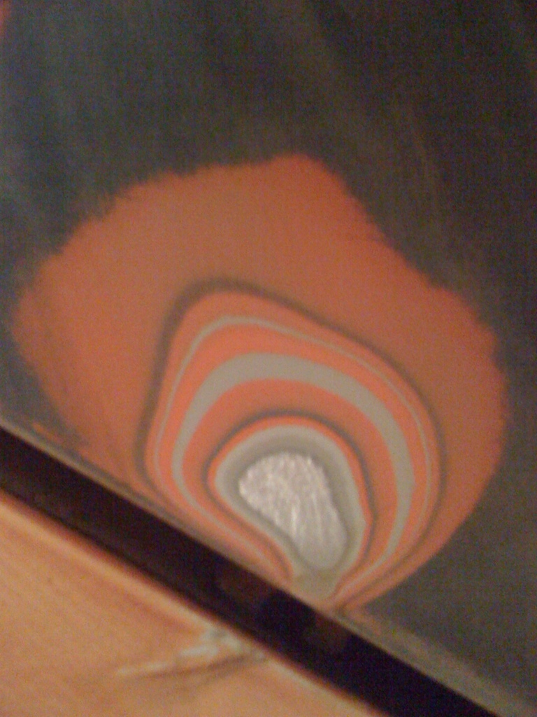

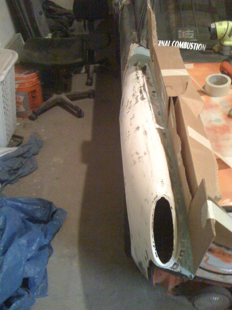

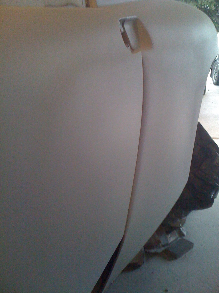

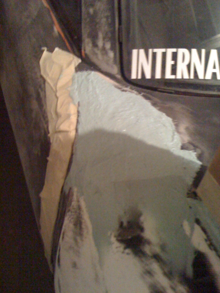

Paint on the headlight cover. Yup, thats a lot of layers... Most of the car goes down to bare metal this go around so its not that big of a deal.. Just a lot of paint to take off...
(IMG:http://www.914world.com/bbs2/uploads_offsite/i1210.photobucket.com-172-1300948638.4.jpg)

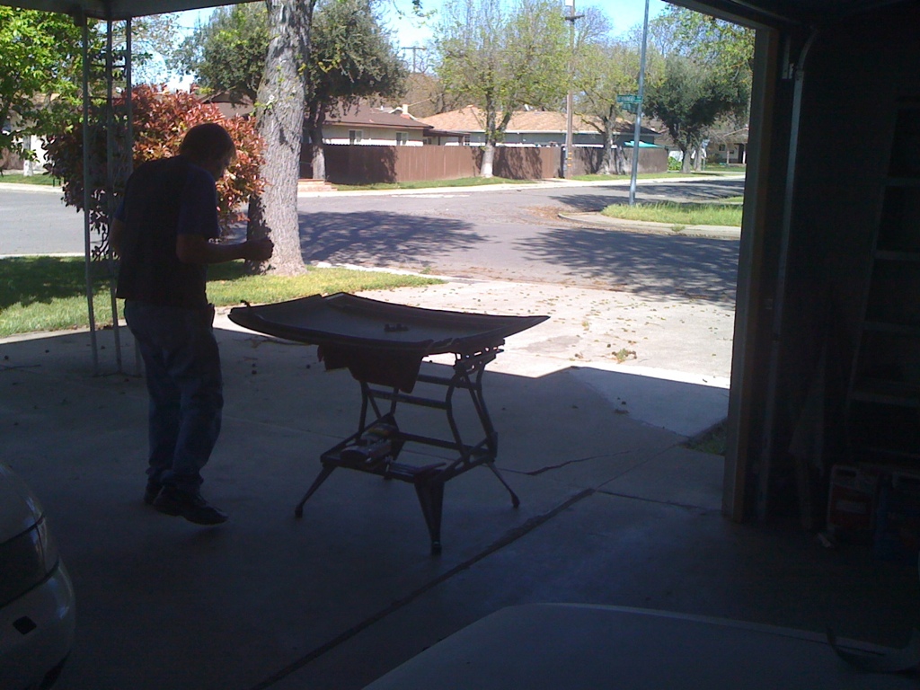

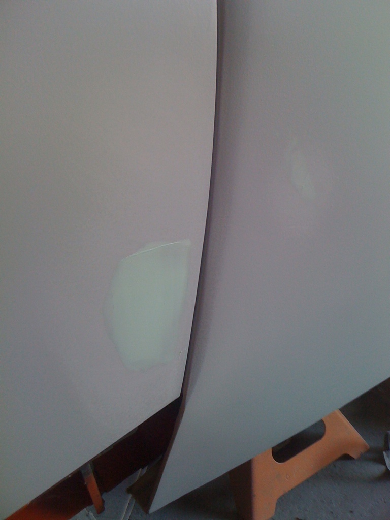

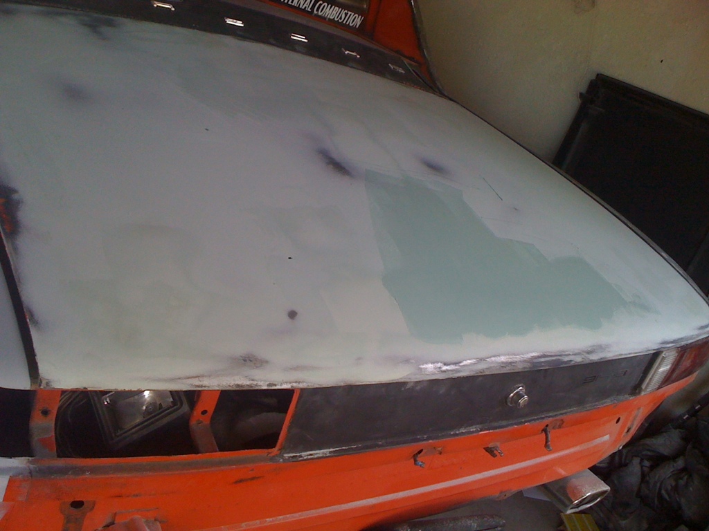

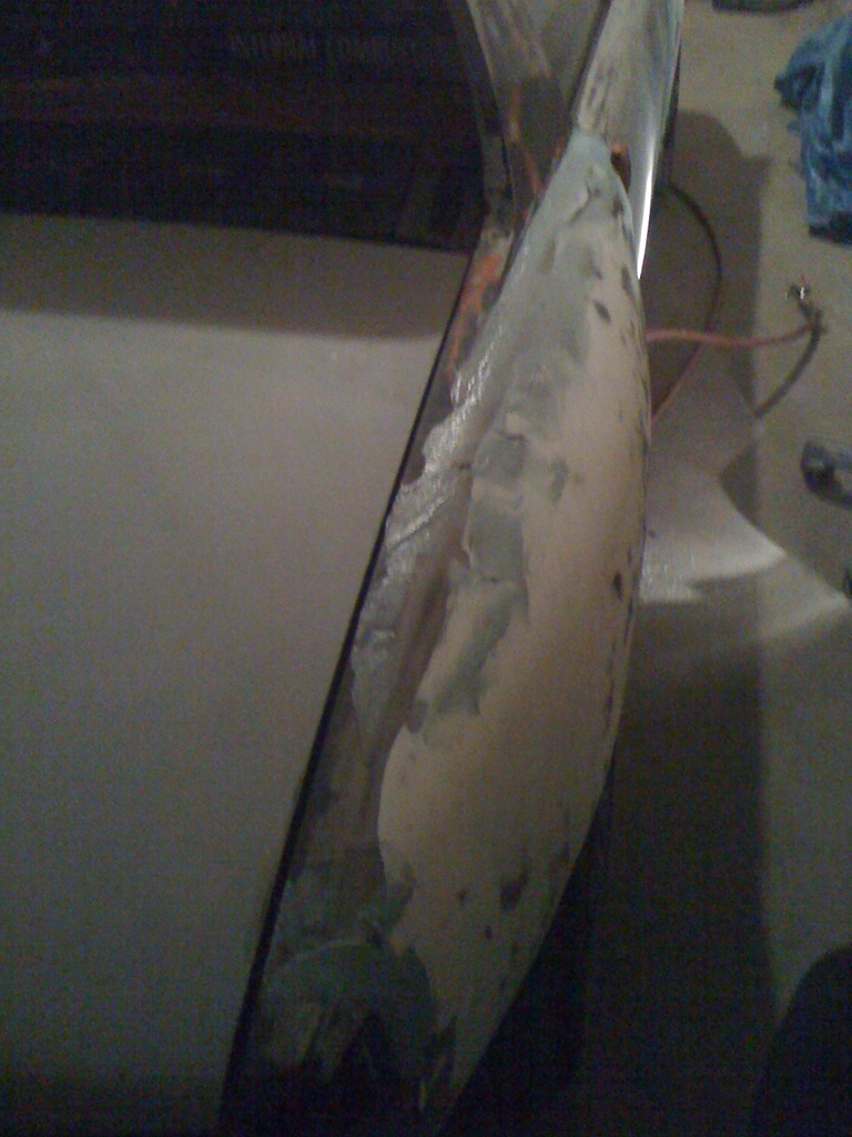

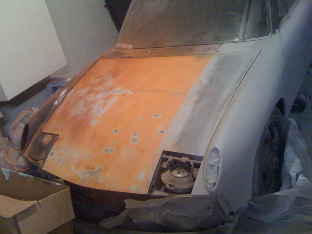

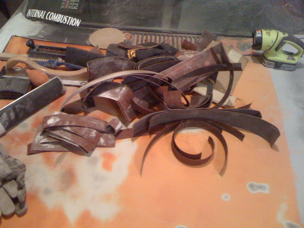

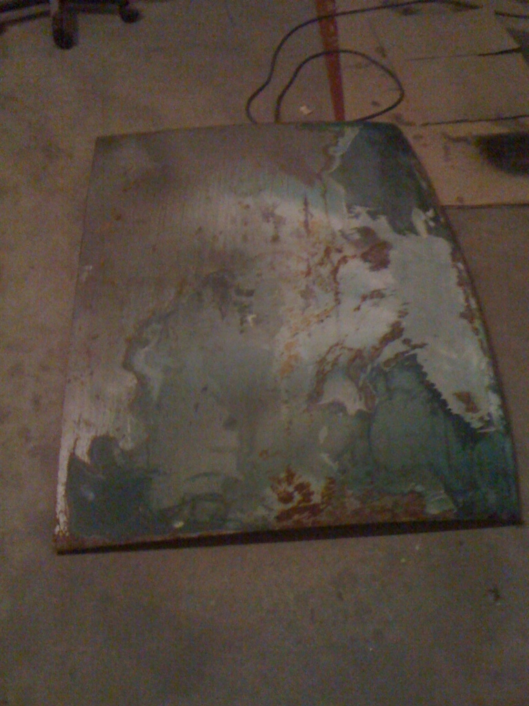

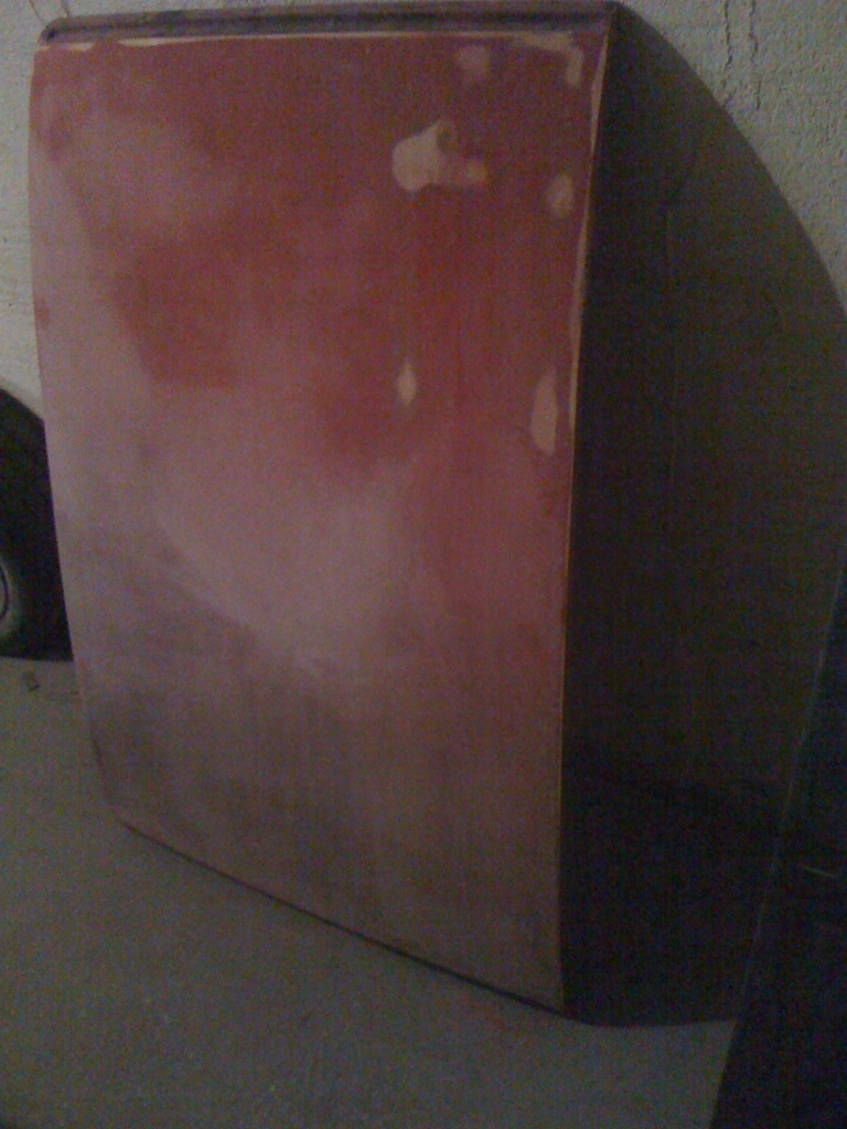

Front hood, Focused on taking area's with paint chips to bare metal. The whole trunk is smooth, but i'd like to get it down to the original primer at least (2 layers). My DA isnt working well, and the paint is pretty darn hard.. My air longboard with 80 grit cuts it, but its really taking a long time.

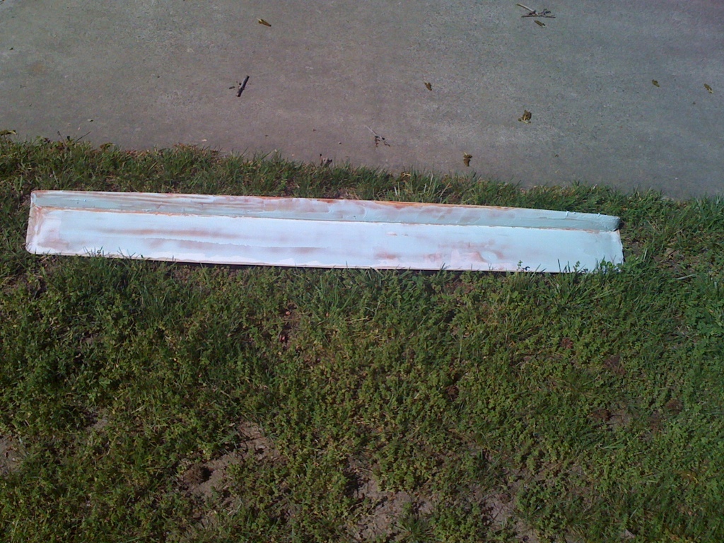

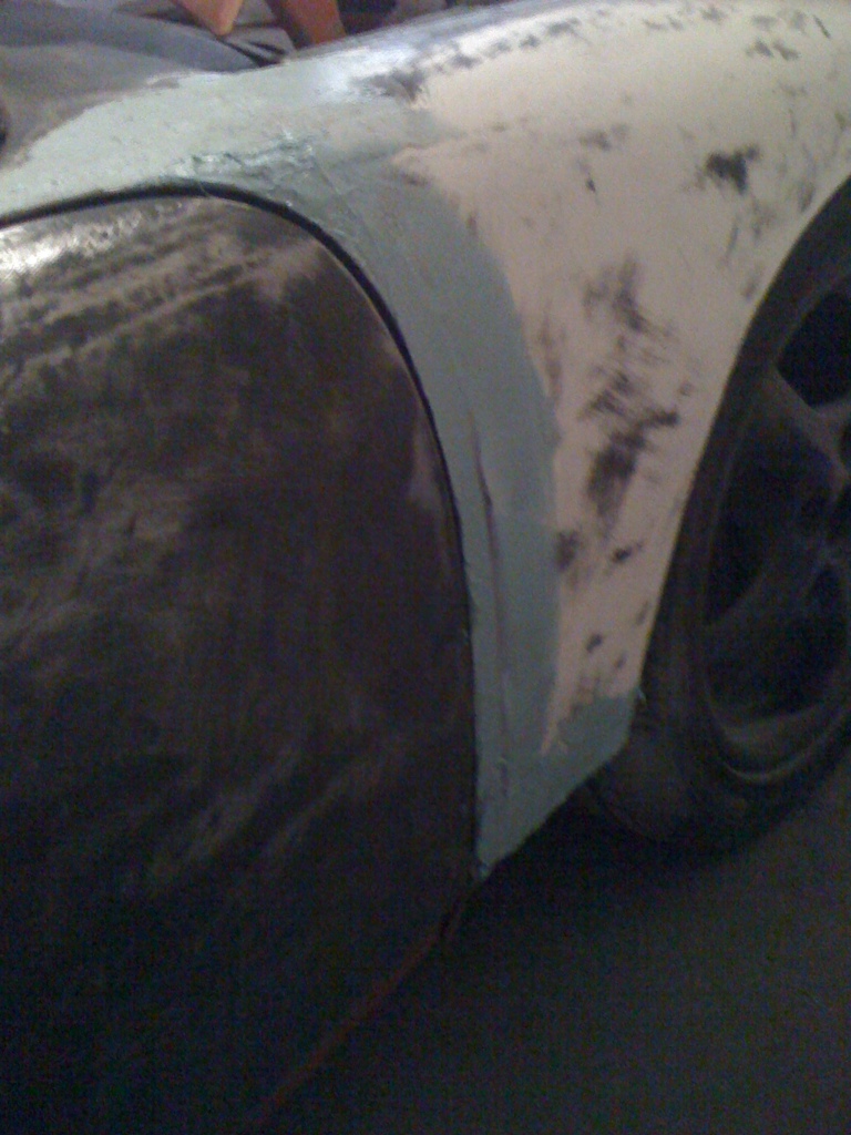

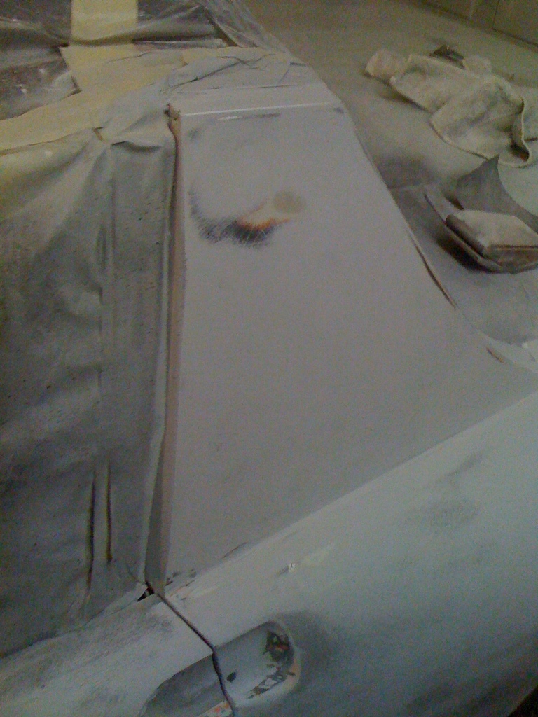

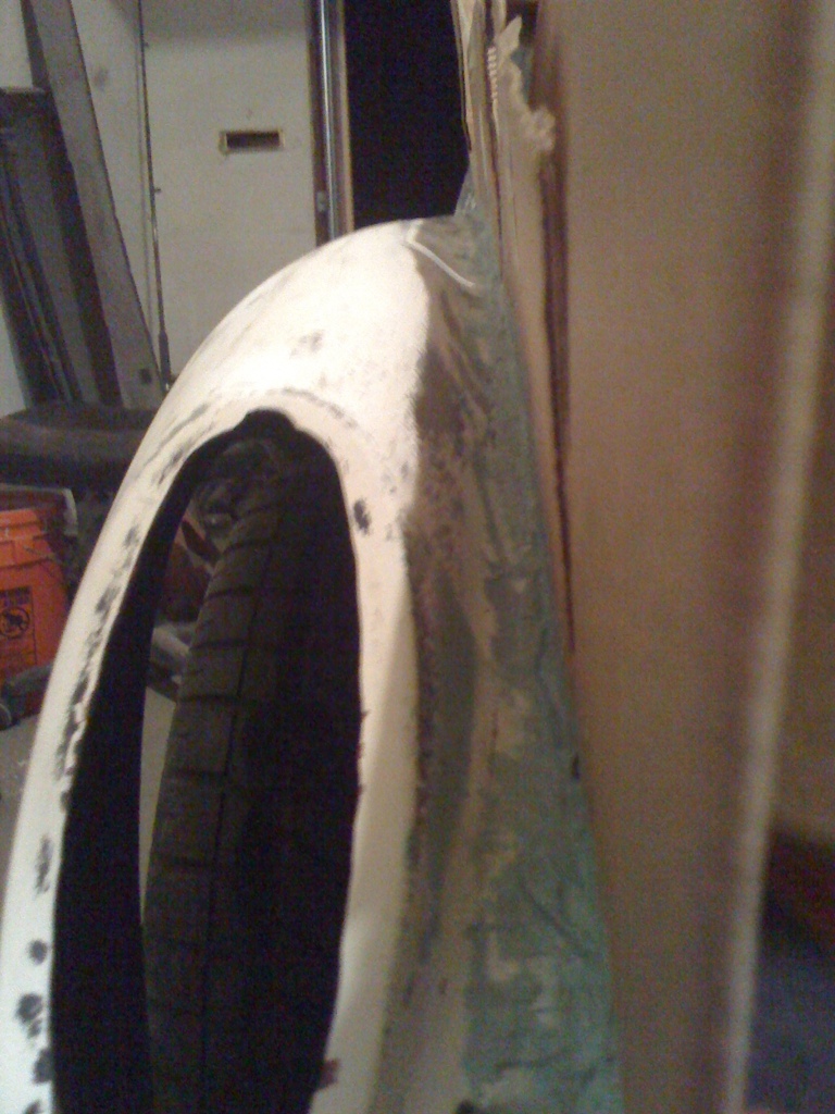

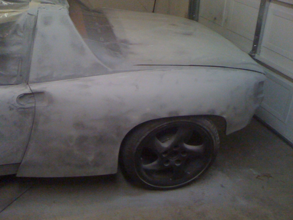

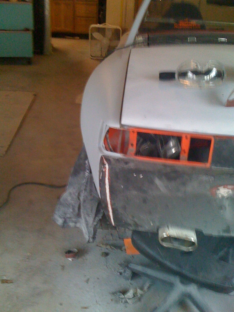

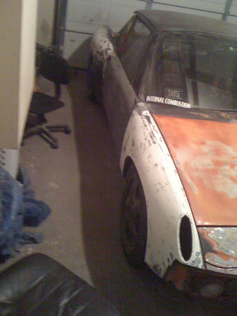

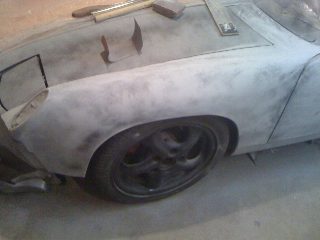

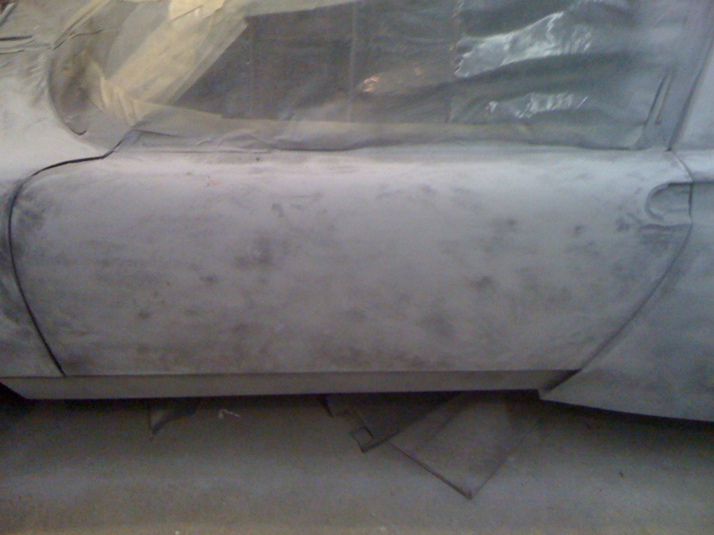

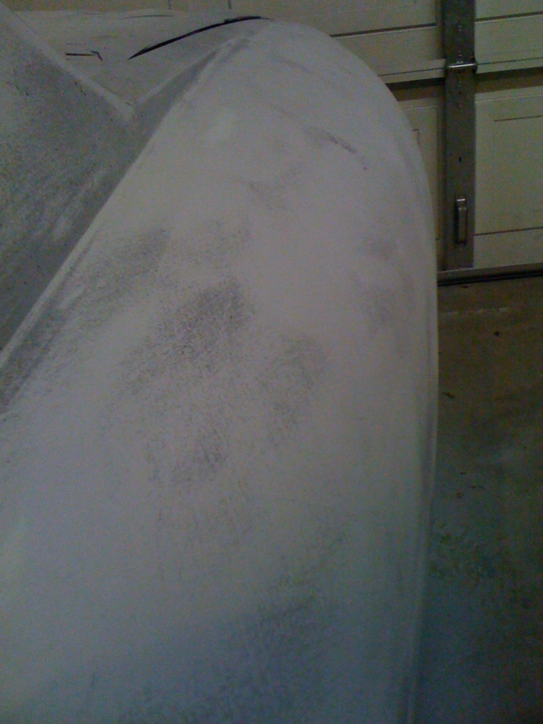

Spent some time on the rear bumper, sanded down a BUNCH of bondo that is on it. this bumper is a mess... Oh well, its just a bumper, maybe i'll get creative with it.
Thoughts on me sectioning out the white area to get the bumper to match the new flare lines more?
(IMG:http://www.914world.com/bbs2/uploads_offsite/i1210.photobucket.com-172-1300948638.5.jpg)
(IMG:http://www.914world.com/bbs2/uploads_offsite/i1210.photobucket.com-172-1300948639.6.jpg)

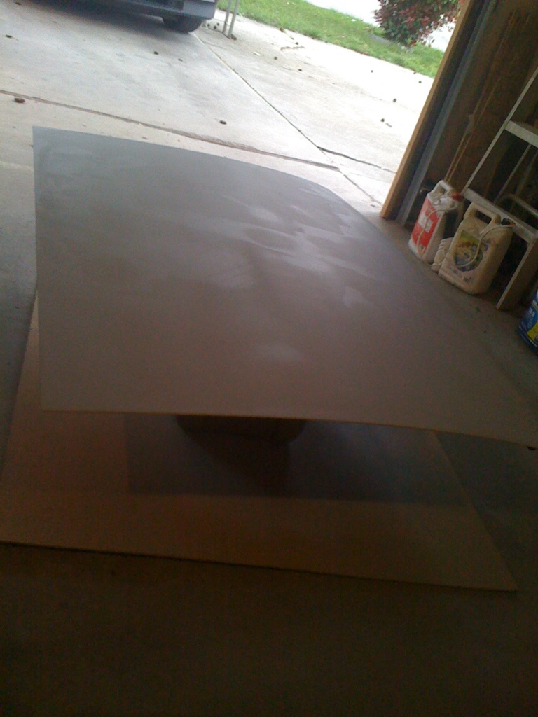

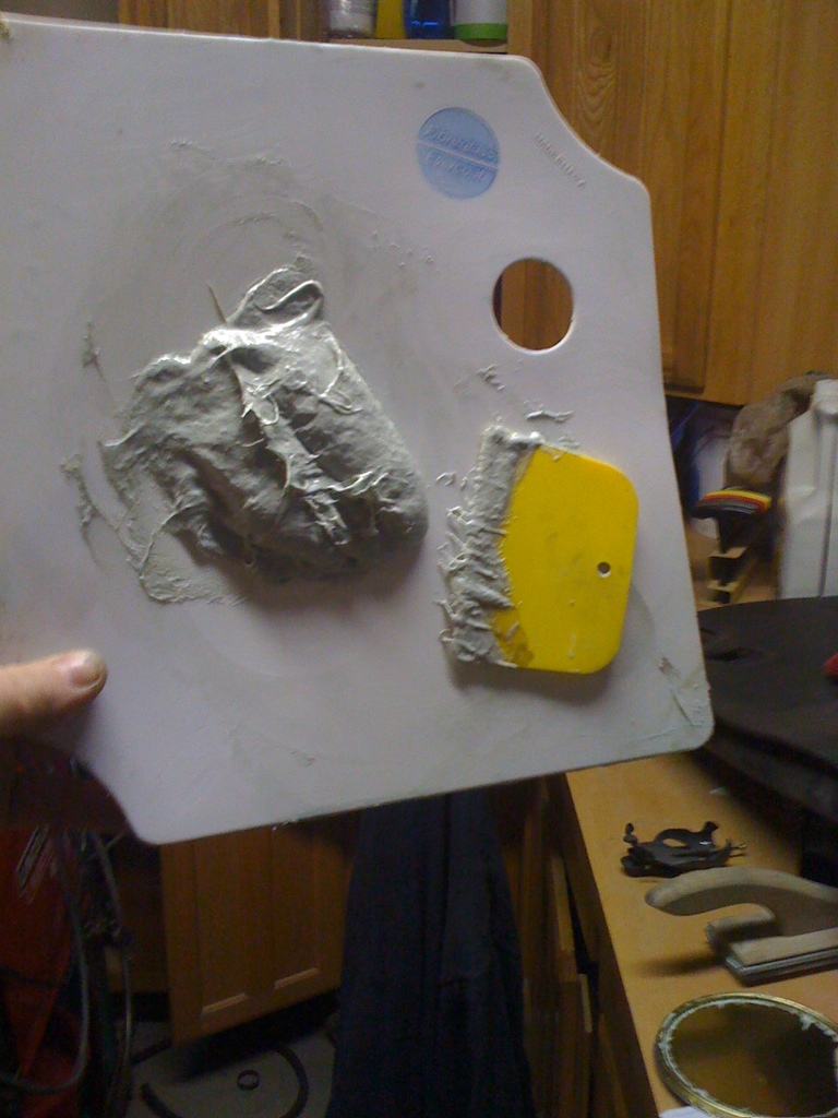

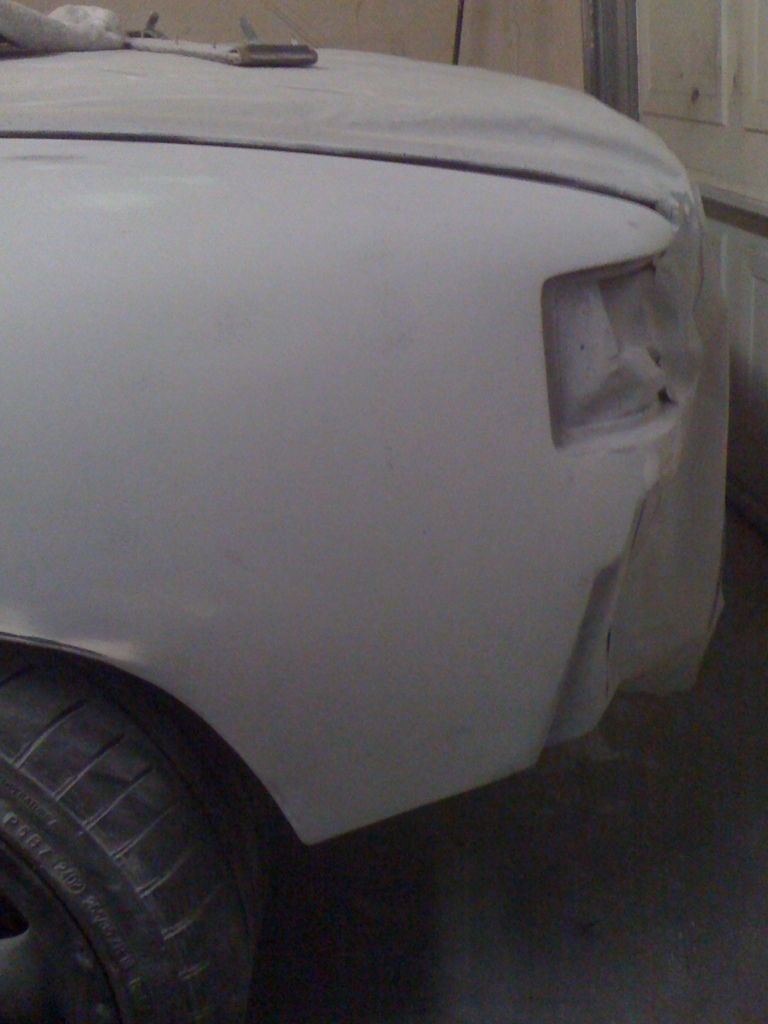

Spent 25 bucks and got a REAL primer gun.. 1.8 tip. Gun was on sale for 15, regulator and dryer was 10. HF special.

Andyrew   PRIMER DAY!!! I should have done some...   Feb 20 2011, 03:42 AM

Andyrew   Sprayed about 4 layers of primer on... Stupid be m...   Apr 16 2011, 12:52 AM
