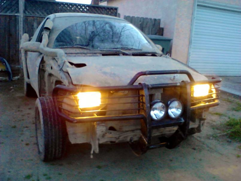

My friends geo with what took so much welding. Full size truck brush guard, sectioned and cut down. Welded to the sides and to the 1/8" skidplate on the bottom of the car.
Yes, this car DOES see mud.

Andyrew   My friends geo with what took so much welding. Ful...   Mar 24 2011, 12:40 AM
