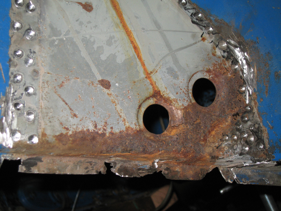

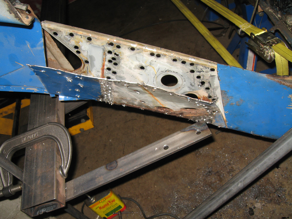

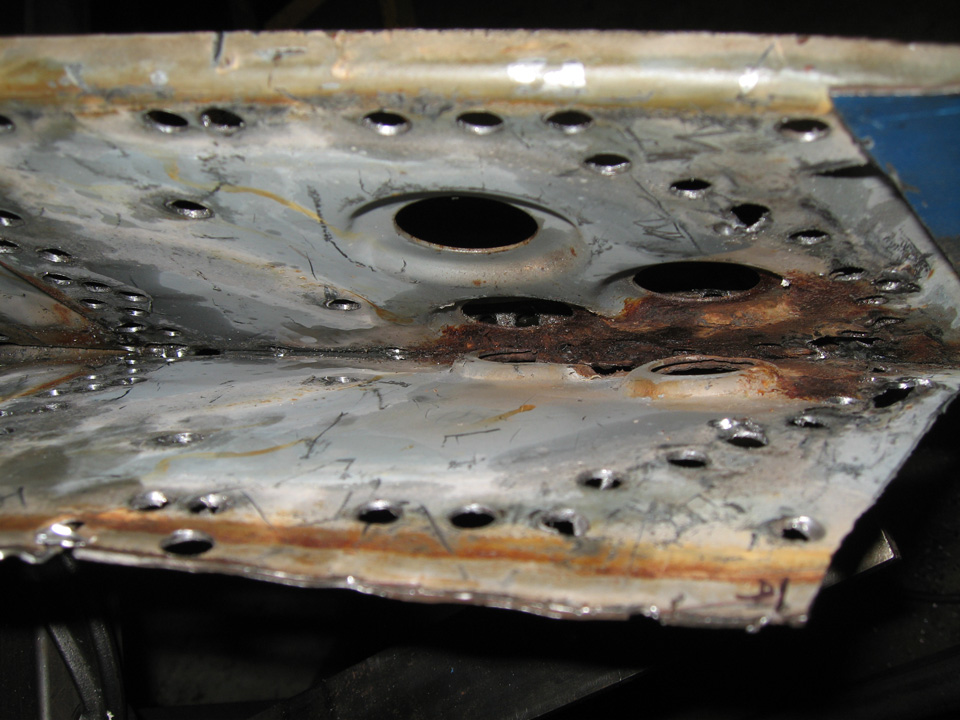

I thought I had gone to the core of it, that no more rust lay hiding, but those 2 little holes kept taunting me.
(IMG:http://www.914world.com/bbs2/uploads_offsite/www.914club.com-11782-1301459732.1.jpg)
Outside it looks solid of course
(IMG:http://www.914world.com/bbs2/uploads_offsite/www.914club.com-11782-1301459733.2.jpg)
I'm glad at this point that I took it off though it was further than I ever intended to go.
(IMG:http://www.914world.com/bbs2/uploads_offsite/www.914club.com-11782-1301459733.3.jpg)

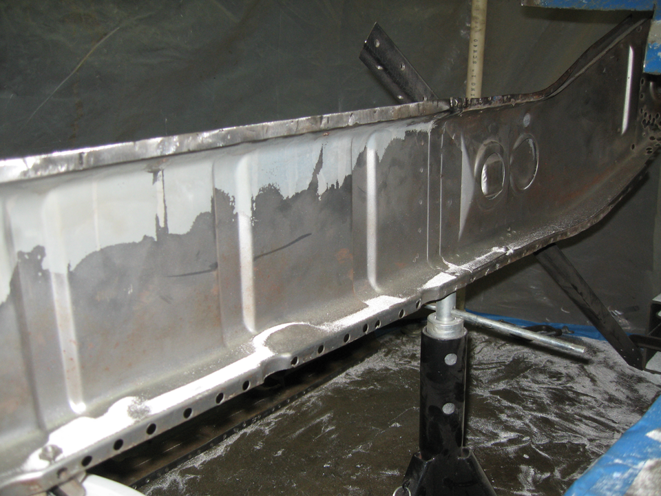

The console itself being made of thicker metal was not as bad as what lay against it.
(IMG:http://www.914world.com/bbs2/uploads_offsite/www.914club.com-11782-1301459734.4.jpg)

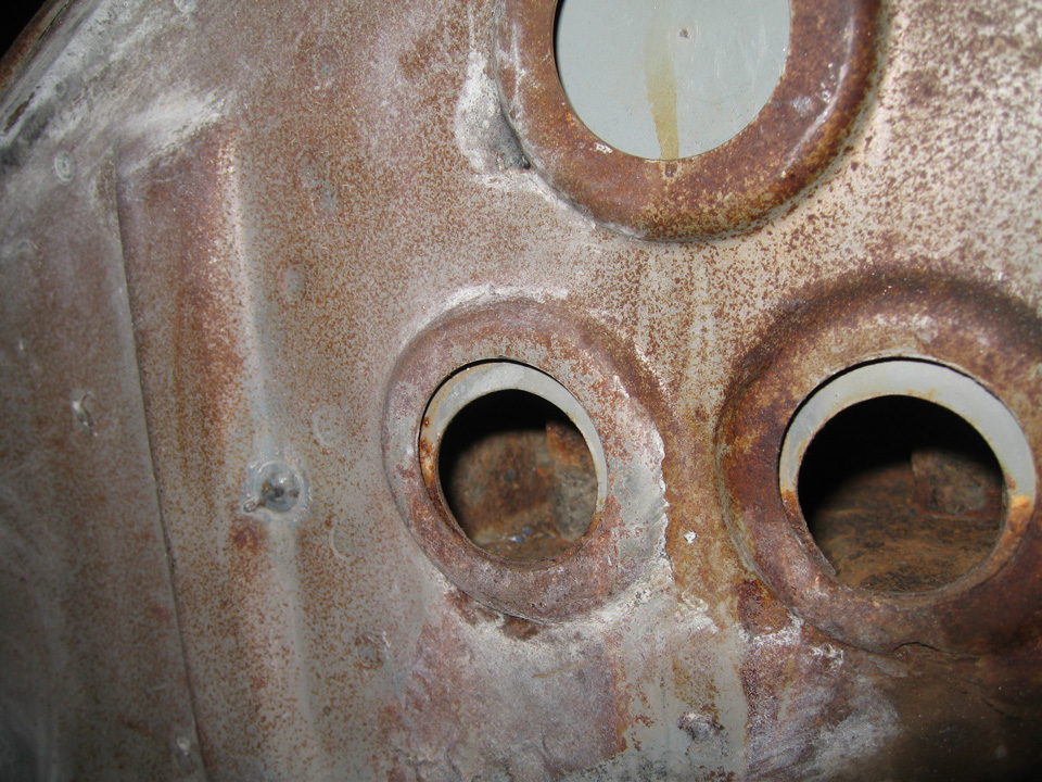

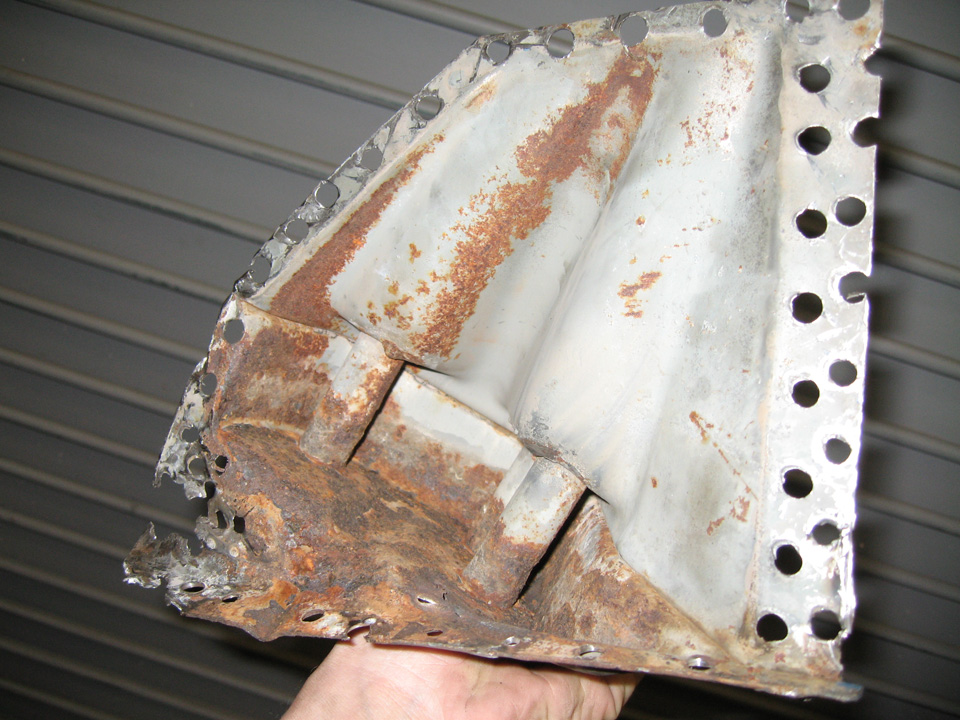

That drip there comes from a hole that comes through the long. Why they would have situated it right there to drip down on those 2 double layer holes is proof that someone was an idiot or that they made these cars to rust on purpose.
deeper
(IMG:http://www.914world.com/bbs2/uploads_offsite/www.914club.com-11782-1301459734.5.jpg)

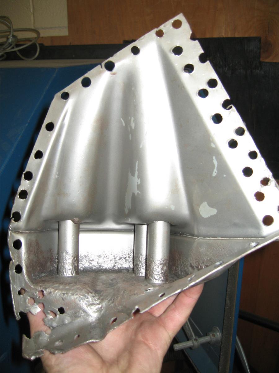

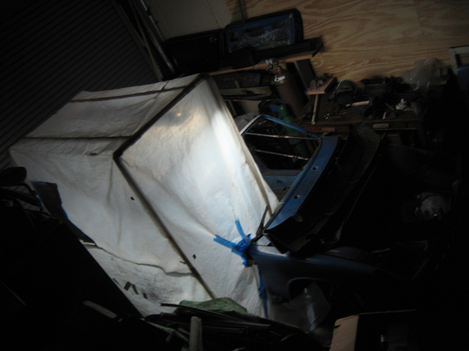

I'd stalled a bit before getting into all that, got some glass beads, 5 gallons. I tried to upgrade my compressor, but not yet, so a lot of waiting for the tank to fill.
I've put my containment chamber about the construction.
(IMG:http://www.914world.com/bbs2/uploads_offsite/www.914club.com-11782-1301459735.7.jpg)
My friend made that for me, the frame of it out of pvc pipe and fittings, as a work table light support. I sewed the drop cloth surround part to contain grinding dust. I played with using it as a paint booth on a small scale. It's getting pretty rough, so I've sacrificed it, I've sectioned it around the 914, trying to contain the bead blasting.

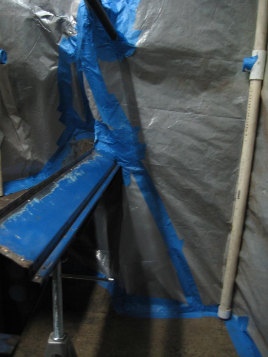

(IMG:http://www.914world.com/bbs2/uploads_offsite/www.914club.com-11782-1301459735.8.jpg)
(IMG:http://www.914world.com/bbs2/uploads_offsite/www.914club.com-11782-1301459736.9.jpg)

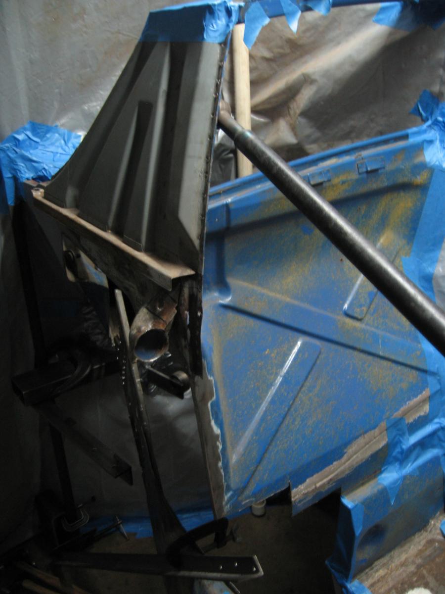

There's a glimpse of the 'jig' there for the outer suspension console. I'm trying to make that as short term as possible and also I'll be verifying placement by measurement, before trusting it at all. I may have some questions about that when the time comes (soon!).
Working my way back. The rust is starting to come back already. I'll hit it again before I etch it, got to get my etching stuff. I think I'm going to the paint store this weekend.

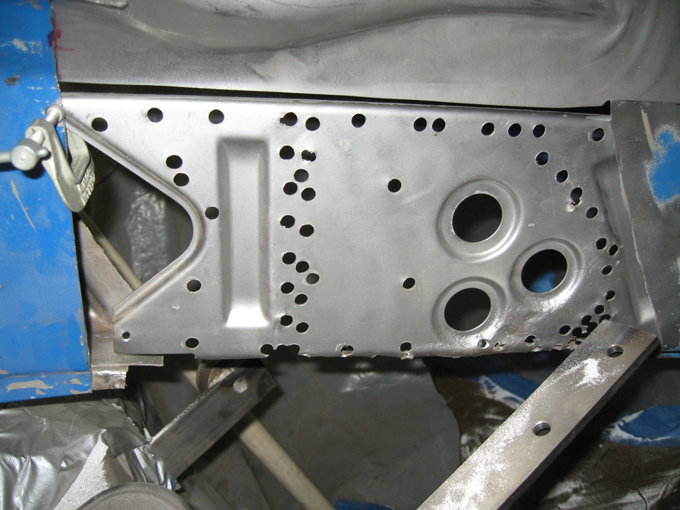

A little thin in a place or 2 but I've finally reached something solid! The suspension console outer was held on by more than a few welds.
(IMG:http://www.914world.com/bbs2/uploads_offsite/www.914club.com-11782-1301459738.11.png)
Still a little more blasting to do on this but looking much better

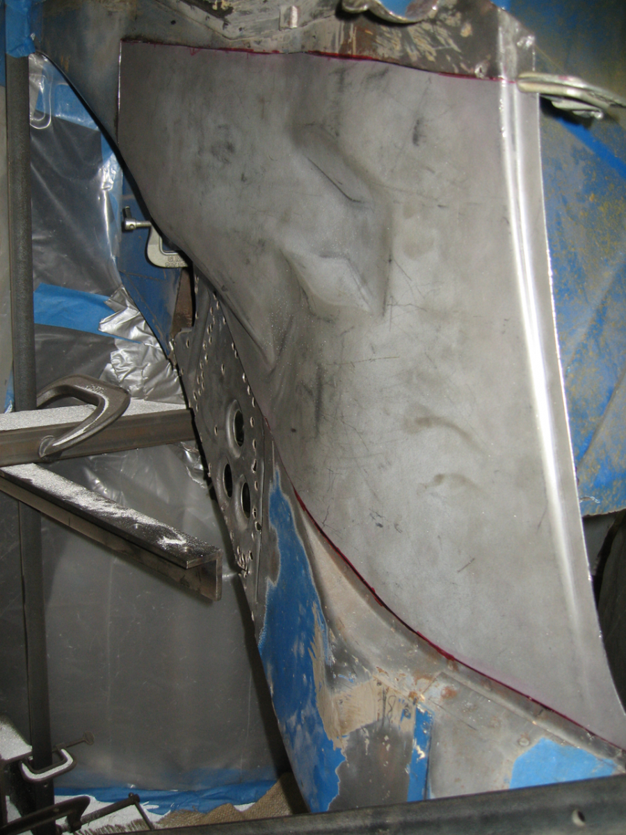

I've been filing that, the inner fender well upper for a few days now. I will start fitting the piece below tomorrow. I have 2 cans of 3m weld thru primer, and if I get the etch stuff, maybe I can be welding the outer suspension console back on this weekend! (IMG:style_emoticons/default/welder.gif)
