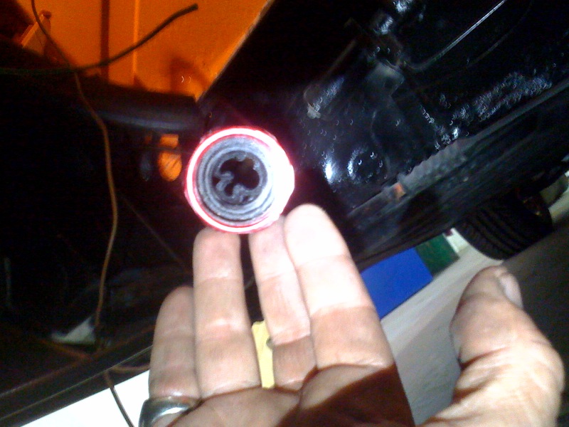

This supply line freaks me out. -16 supply, but probably only -10 in flow:

Series9   This supply line freaks me out. -16 supply, but p...   Mar 30 2011, 09:42 PM
