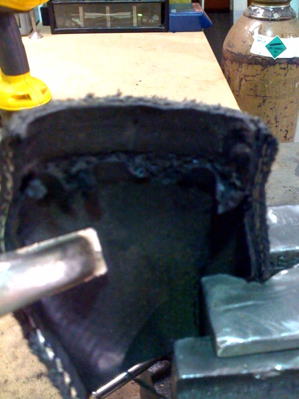

Remember that picture of the blockage in the oil supply line?
I cut the end of that hose off and opened it up to have a look. I'm not sure the source of this hose, but this makes me wonder if it's compatible with the fitting that was installed on it (Earl's -16 straight).
The lining was detached. Very scary for the engine if this stuff came off. Now I'm going to have to pull the other end off the oil tank to see if it looks the same.
For a car that was previously running a /6, I'm having to almost start from scratch on the conversion stuff because it was either under-done or done incorrectly.
Whatever. It'll be right when it leaves here.
