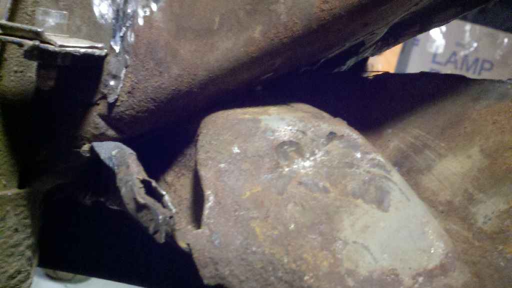

So I notice my passenger rear wheel camber was way off. That side of the car was sagging a little bit. I figured something came loose. I jack up that side of my car (IMG:style_emoticons/default/headbang.gif) (IMG:style_emoticons/default/headbang.gif) (IMG:style_emoticons/default/headbang.gif) (IMG:style_emoticons/default/headbang.gif) (IMG:style_emoticons/default/headbang.gif) (IMG:style_emoticons/default/headbang.gif) (IMG:style_emoticons/default/headbang.gif) (IMG:style_emoticons/default/headbang.gif) (IMG:style_emoticons/default/headbang.gif) (IMG:style_emoticons/default/headbang.gif)
Take a look at my suspension ear (IMG:style_emoticons/default/hissyfit.gif) (IMG:style_emoticons/default/hissyfit.gif) (IMG:style_emoticons/default/hissyfit.gif)

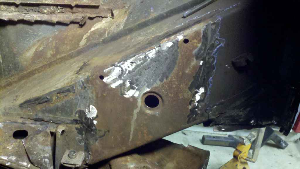

Made some progress tonight. I got the upper half of the suspension ear off. I'll be finishing up the bottom half tommorow. Damn it took a while to do the top. I've got quite a bit of the bottom allready. Getting a little better feel for my grinder now. My battery tray had some rust on it & I cut it off. There is some on the wall there also. The hell hole is solid but I have some surface in that hole area I need to clean up. I still need to get off the small section of battery tray attatched to the side. I'll get that off tomorrow too. Then clean up, prime & paint the area. Well not paint yet. I need to get my new ear welded on first.
Overall I had a much better night working on it that the last time (IMG:style_emoticons/default/smile.gif) .

kwales   That's a combo rust/fatigue crack and has been...   Jul 16 2009, 05:51 PM

JRust   Made some progress tonight. I got the upper half o...   Apr 1 2011, 11:20 PM
