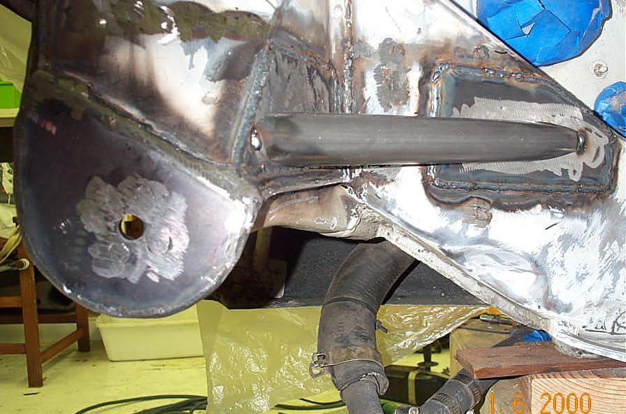

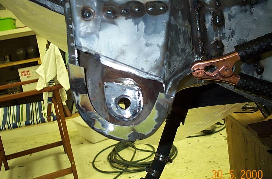

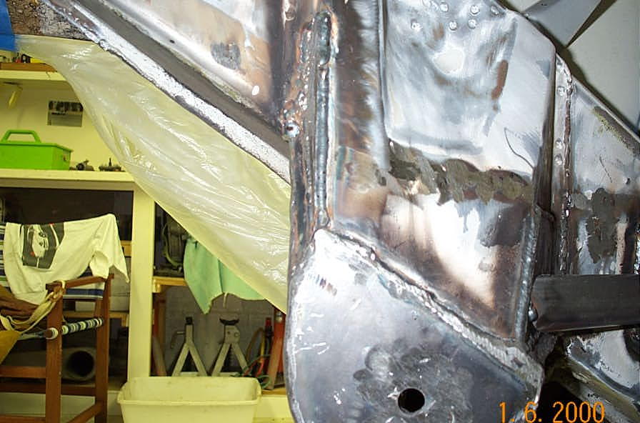

It's kinda late now but.....it's better to fix it before it breaks.....easier too. (IMG:style_emoticons/default/biggrin.gif)
If one side goes, the other is probably close behind, me thinks.
There are a few things can do that (I believe) help "things" along without turning it into a major project. Seam welding everything in the area ....both sides, including the pinch seam around the perimeter of the ear itself. I did that long ago and it never broke.....but it didn't have my total trust.
So, I made a major project of it.(IMG:style_emoticons/default/biggrin.gif)
The "since I'm here" scenario can be a good thing.
