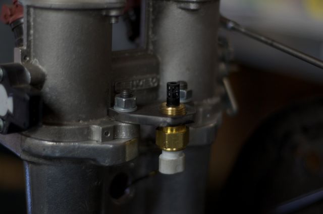

Here is another Original Customs application. This is something that Mark has done on a few EFI engine builds so it is tested and works. One of the parameters SDS uses to meter fuel is the temperature and thus, density of the intake air. This is the IAT or intake air temperature sensor. Mark has fabricated a mount that puts this between the air cleaners on the right side throttle bodies.
