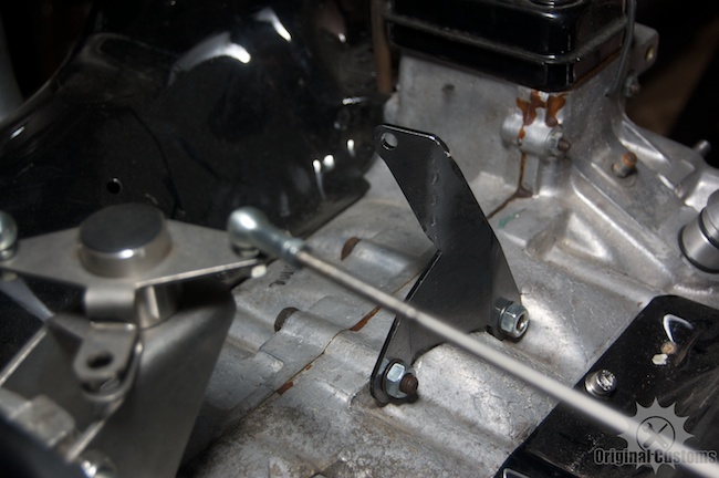

ConeDodger   Here is another Original Customs application. This...   Apr 7 2011, 08:31 PM
kg6dxn   Rob, That engine needs a car! Hurry up! :...   Apr 7 2011, 08:57 PM
ConeDodger   Rob, That engine needs a car! Hurry up! ...   Apr 7 2011, 09:18 PM
kg6dxn   (ignore the damned garbage can Bovey!) :bli...   Apr 7 2011, 09:21 PM
McMark   Booyah!   Apr 7 2011, 09:07 PM
ConeDodger   Now that is a very accurate linkage set up. Mark h...   Apr 7 2011, 09:14 PM
