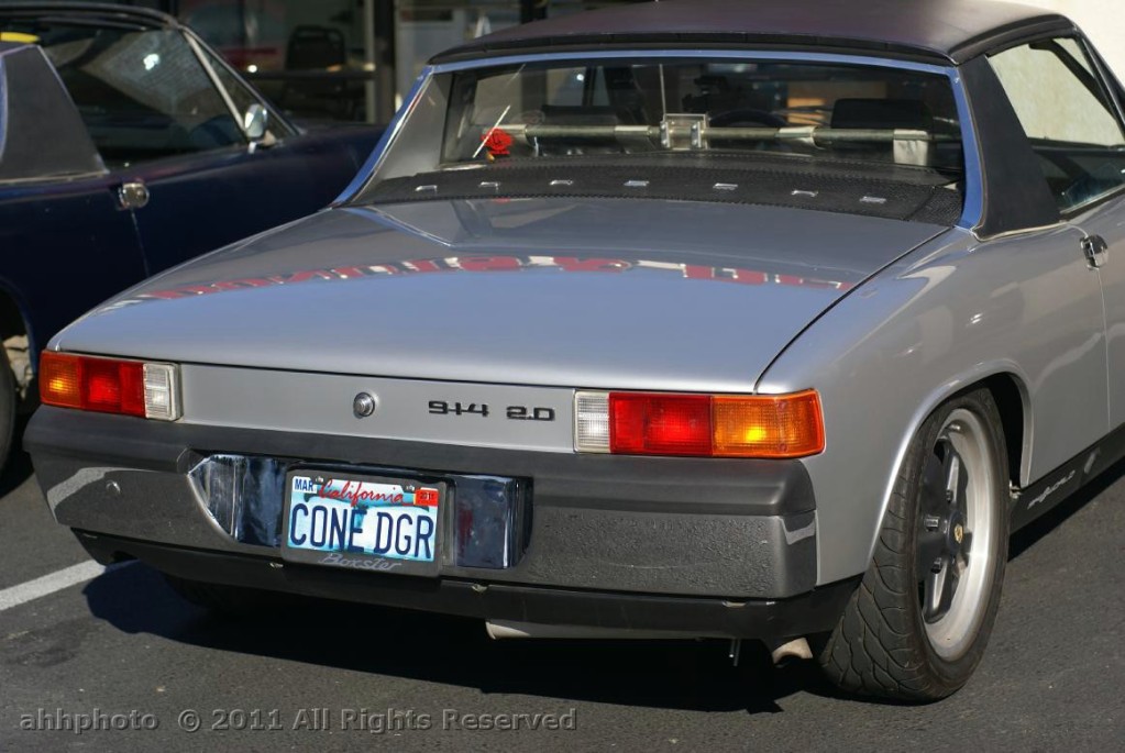

ConeDodger
post Apr 7 2011, 09:18 PM
Apex killer!
Posts: 24,670
Joined: 31-December 04
From: Tahoe Area
Member No.: 3,380
QUOTE(kg6dxn @ Apr 7 2011, 06:57 PM) *
Rob,
That engine needs a car! Hurry up! (IMG:style_emoticons/default/beer.gif)
Mike - it's going to go about 3 feet in front of this license plate... (ignore the damned garbage can Bovey!) (IMG:style_emoticons/default/blink.gif)
