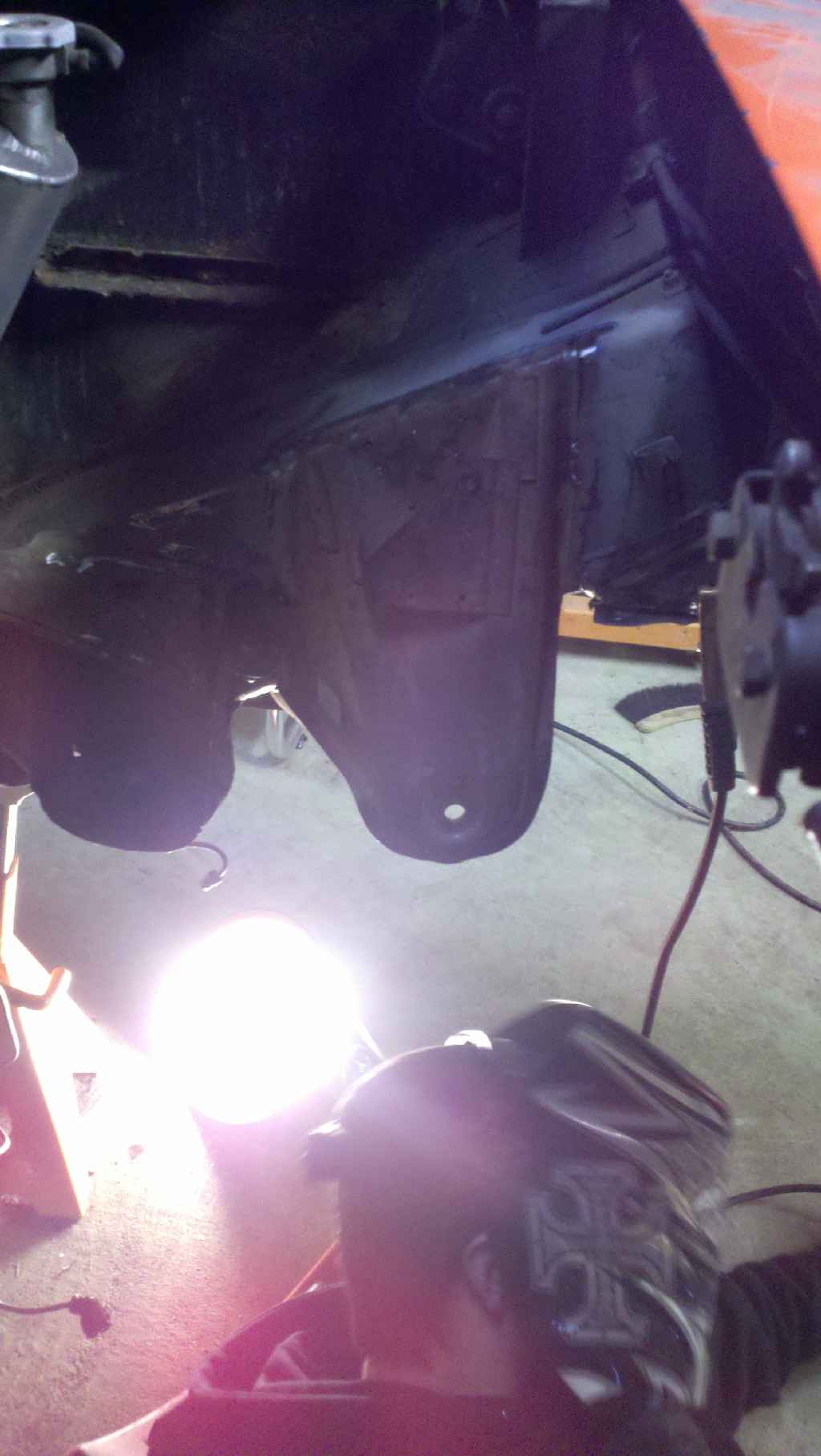

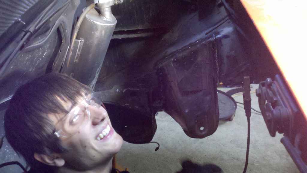

Member No.: 129
Made great progress today! Ian came down to weld my new ear in place. I needed to clean the metal up more in prep. Then did alot of measuring to make sure we got it set in place. Always nice having another 914 there handy to measure off of. Anyway the new ear is in & nice & solid. I can't wait to get my v8 off the stand & get a tranny bolted up. Although with the clinic coming in a few week probably not much point to that. I do need to finish cleaning the battery tray area. It was rusted but the hell hole is in good shape. Still there is some on the wall I need to clean up. So I'll spend some time in there with a wire wheel. Then repaint it before the motor get's back in place.
Huge thanks to Ian for coming down & (IMG:style_emoticons/default/welder.gif) for me. Don't worry I will be hooking you up with plenty of parts during your build (IMG:style_emoticons/default/biggrin.gif)
