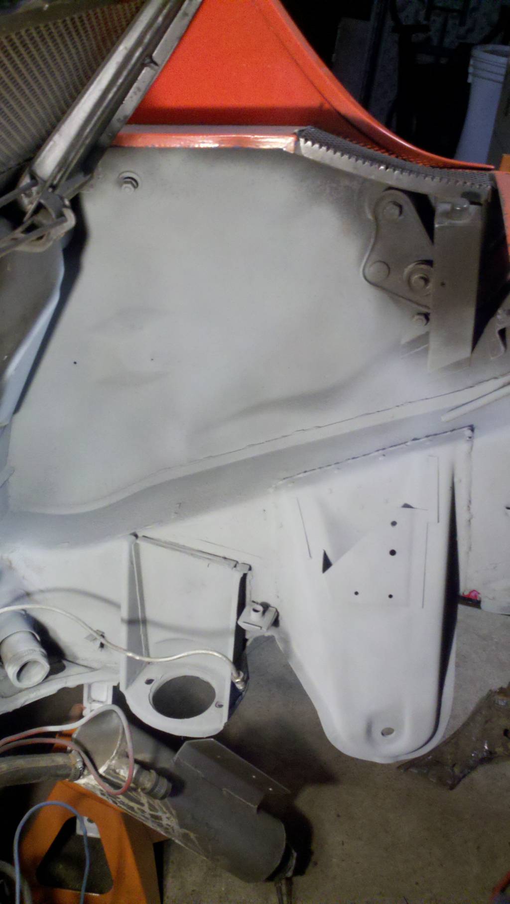

So here is a pic with the battery tray gone. All the surface rust cleaned off. Then everything primed. I've still got a couple small pieces to grind off I missed. Basically ready to install my new support & tray. I also have the CFR suspenion ear stiffening support to go on. Along with the extra piece welded to the firewall & the ear for extra support.
Thanks to Restoration Design for the battery support & tray. I should have them soon (IMG:style_emoticons/default/biggrin.gif)
