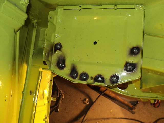

I painted everything, then added the battery tray with cold welds
watsonrx13
post Apr 25 2011, 05:14 AM
Posts: 2,735
Joined: 18-February 03
From: Plant City, FL
Member No.: 312
Rick can you explain the term 'cold welds'?
BTW, the car is looking great... (IMG:style_emoticons/default/aktion035.gif)
-- Rob
QUOTE(rick 918-S @ Apr 24 2011, 07:57 PM) *
rick 918-S
post Apr 25 2011, 07:00 AM
Hey nice rack! -Celette
Posts: 21,388
From: Now in Superior WI
Member No.: 43
QUOTE(watsonrx13 @ Apr 25 2011, 06:14 AM) *
-- Rob
I turned the settings down to the lowest on my mig. My goal is to just attach the tray and keep the paint burn to a minimum. The tray is not structural in the way a jack post or a seat mount is. The bolt that holds the battery is also actually in the stand so inertia from the battery is transfered there. I also don't weld the tray to the vertical inner panel. I use urothane seam sealer and bond it. The poor inner panel is usually thin from battery acid. I don't see the need to weld the tray back to the inner panel.
Edit: I since changed my mind about this when the inertia pulled the battery tray away from the inner panel and split my seam sealer. I ended up tack welding it to the inner after all.
Hey, live and learn.
