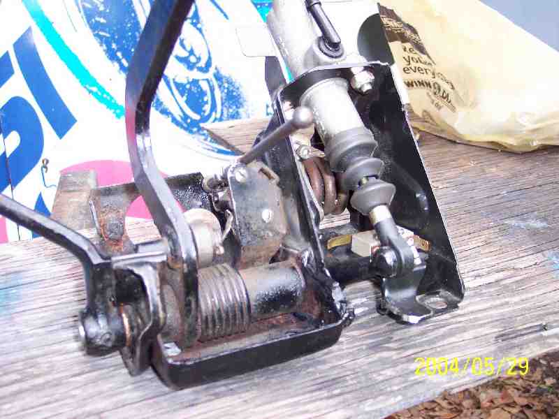

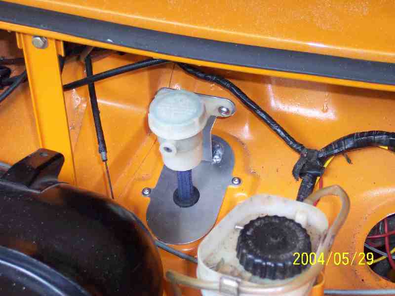

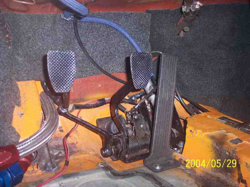

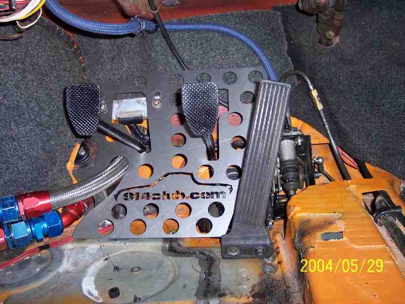

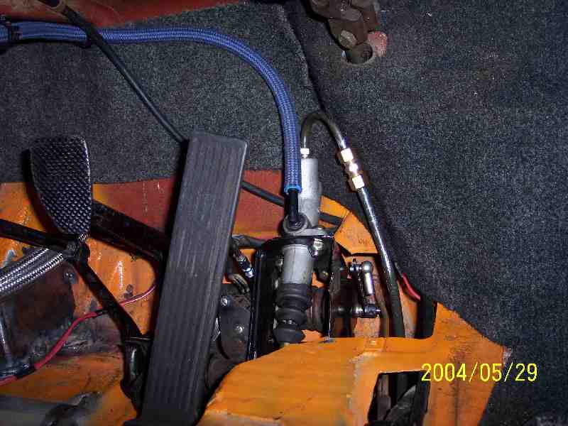

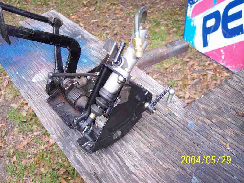

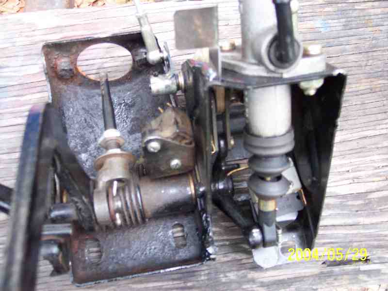

Eric,
I have converted/grafted the 964 slave unit to fit the 914 pedal cluster. It was not a difficult adaption, and it has been working nicely on my 914/6 for over 5 years now with no issues or leakage. It has a smooth linear feel to it. Here are some really old pics taken during the conversion. It did require re routing the throttle linkage and having a custom cable made. Which can cheaply be purchased from Pegasus Auto Racing. Good Luck. Ron Attached image(s)
