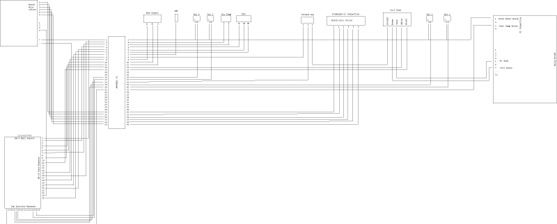

Got the wiring diagram drawn up yesterday. There are about 30 wires to keep track of, which doesn't seem like much until you start researching component pin-outs (which pin of this TPS is signal, power or ground?). And the SDS documentation leaves a whole HELL of a lot to be desired. Too many acronyms and no consistency between different references to the same wire. Oh, and during this I discovered that the stickers SDS put on the coil for which cylinder hooks where were WRONG.
As far as I'm concerned, the only thing simple about SDS is the name. (IMG:style_emoticons/default/tongue.gif)

McMark   Got the wiring diagram drawn up yesterday. There ...   Apr 28 2011, 10:27 AM
ConeDodger   Sorry Mark. Think of yourself as a pioneer. :) Fo...   Apr 28 2011, 11:02 AM
McMark   True. I usually remember to include that caveat. ...   Apr 28 2011, 11:33 AM
