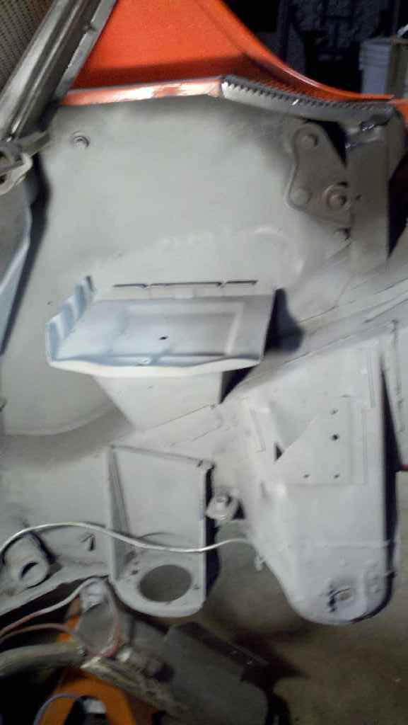

Battery tray installed & one CFR reinforcement piece for the suspension ear. Passenger side is on at least. We'll add the support bar to the firewall next time. Along with doing the driver side. Thanks again for the help Ian (IMG:style_emoticons/default/piratenanner.gif)

JRust   So here is a pic with the battery tray gone. All t...   Apr 22 2011, 12:17 PM
PeeGreen 914   Or you could take this excellent time to relocate ...   Apr 22 2011, 12:24 PM
JRust   Or you could take this excellent time to relocate...   Apr 22 2011, 12:51 PM
