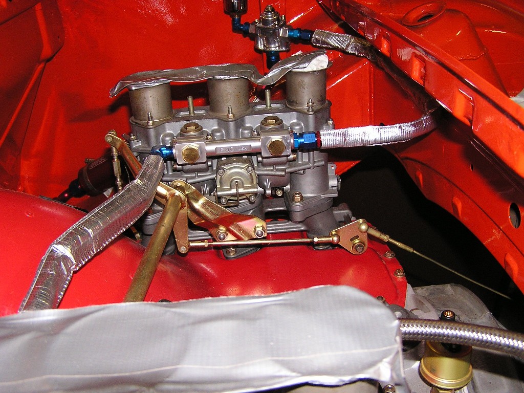

So I have a set of tangerine racing fuel lines installed. Should I route the fuel in the engine compartment so that that it flows from one carb to the other, then to a pressure regulator, then return fuel to tank?. It looks like originally the fuel lines dead end at each Weber.

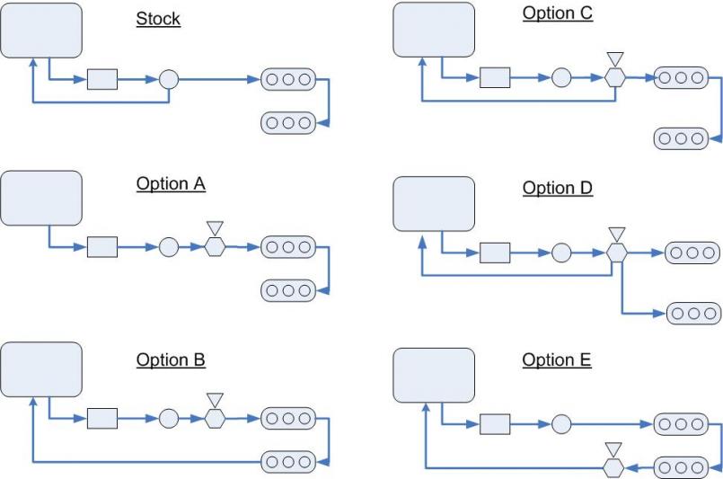

A return line is good for power (at least theoretically)
lots of ways to route this:
