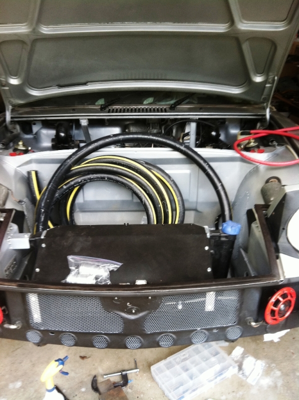

Ordered the Gates radiator hose from Renegade Hybrids and reinstalled the front wiring harness.
Still need to install the hose.

Zaney   Ordered the Gates radiator hose from Renegade Hyb...   May 3 2011, 02:23 PM
