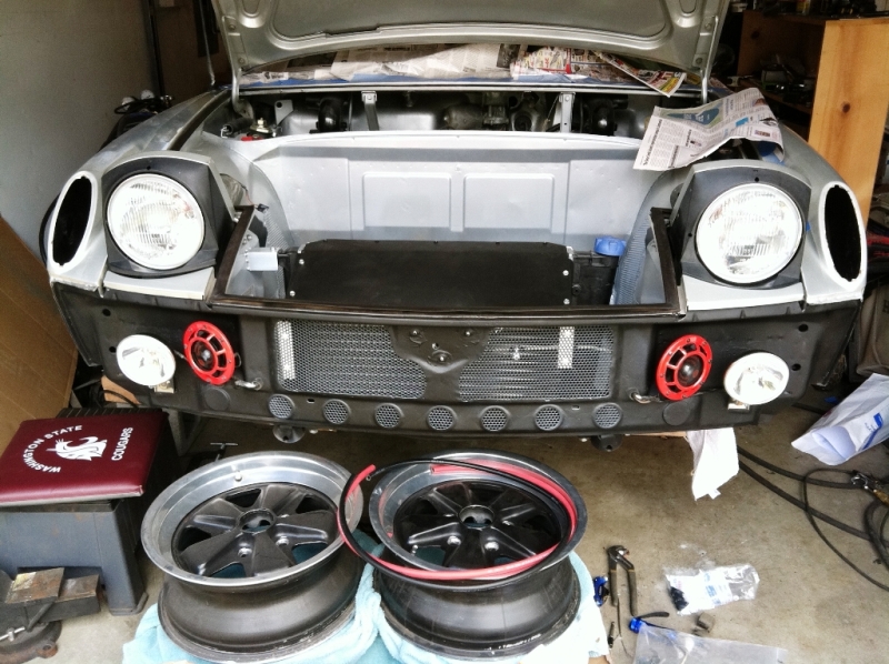

Been too long since I have posted any progress on the Suby project but, there has been a bit of movement! (IMG:style_emoticons/default/smash.gif)
-Installed the hydrallic clutch master cylinder and ran the hard line to the back. Followed Strawman's idea about using it with the stock pedal cluster.
-Gathered all the necessary pieces for the five lug swap. I did the front strut option and followed Sir Andy's thread for the rears.
-Cleaned up the front trunk and prepped it for the radiator. Cut the exhaust holes and welded in the all of the openings.
-Painted the Fuchs and I am picking up some tires this week!
-Got the Suby manifold flipped over, moved the alternator, and rewired the engine harness to fit.
-Trimmed out all off the unnecessary wires out of the stock Suby harness using Small Car Performance info and made a harness to mate with the Teener.

Zaney   Ordered the Gates radiator hose from Renegade Hyb...   May 3 2011, 02:23 PM
Zaney   Phoenix Red!!! 16x7's! Tir...   May 3 2011, 02:25 PM
