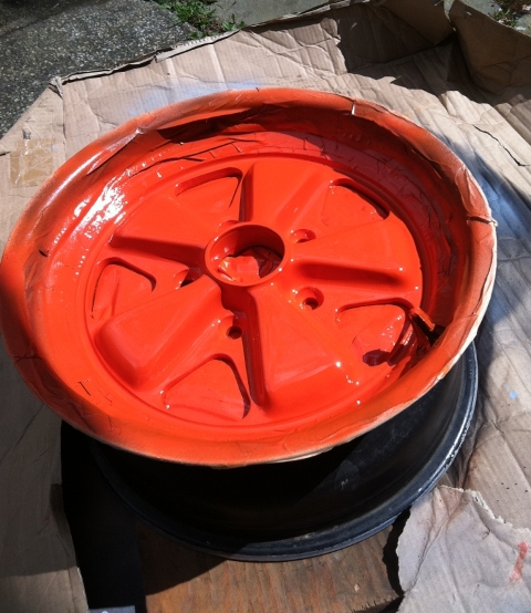

post May 3 2011, 02:25 PM
Deuchland en der Haus
Posts: 461
Joined: 1-March 04
From: Engine 11 Redmond, WA
Member No.: 1,738
Phoenix Red!!!
16x7's! Tires to be picked up this week.
