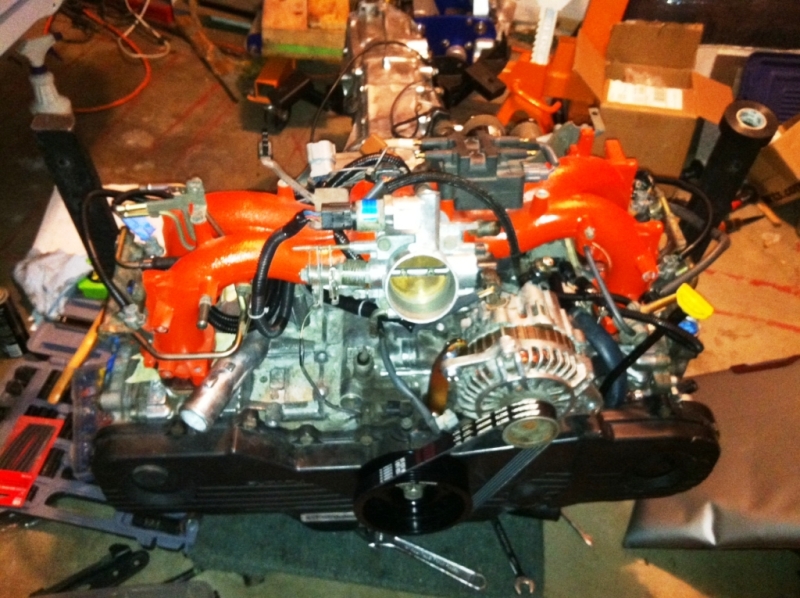

Suby engine!! Ready to be installed! Minus some tubing...
-Still need to route the engine fuel lines with the Walbro fuel pump. Already put in Racer Chris' SS lines.
-Need to order small bits for the front fuel system before putting everthing back.
