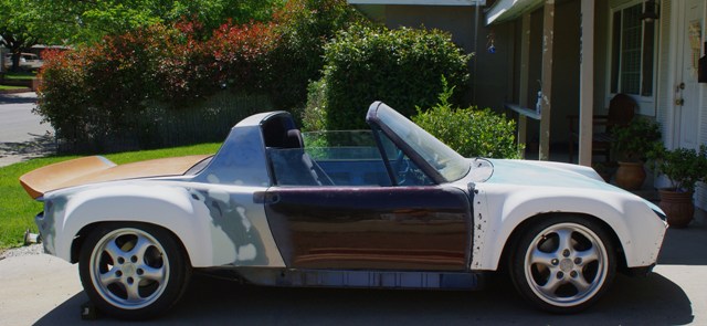

I bought this as a stripped down rolling chassis. The sller put wheels on it to get it on the trailer. That was 4 long years ago. I also had a son at the same time so working on the car has been a second priority. Now the engine is in and the brakes are on, I should be able to get some work done more quickly. I plan on firing this up within the next couple of weeks and taking on a drve by the end of July. I got the 3m adhesive today to get the fenders bonded on and then the fun stuff begins. Hope to get it completed in time for next years West Coast Ramble. Thanks to the support and motivation of the 914World. (IMG:style_emoticons/default/biggrin.gif)

Last fender bonded on!! The car is starting to look like I wanted it to. Unfortunately a piece of metal got past my safety glasses and scratched my cornia (IMG:style_emoticons/default/mad.gif) . I will have to wait a few days to get more done.

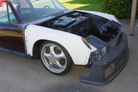

raw1298   Dodging rain today long enough to bond front fende...   Apr 7 2011, 01:56 PM
raw1298   One side left.   Apr 7 2011, 02:00 PM

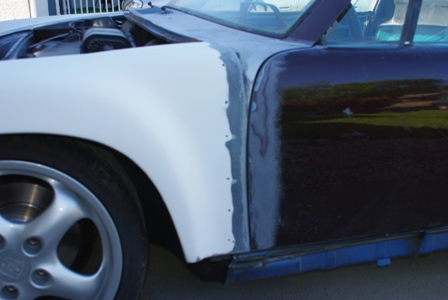

raw1298   Last fender bonded on!! The car is startin...   May 3 2011, 05:09 PM

raw1298   After smoothing down the edges there is very littl...   May 5 2011, 08:57 AM
charliew   I'm betting that will need to be filled all th...   May 5 2011, 02:55 PM
raw1298   I'm betting that will need to be filled all t...   May 5 2011, 06:00 PM
charliew   If I were trying to do this application, I would u...   May 6 2011, 03:32 PM
raw1298   If I were trying to do this application, I would ...   May 6 2011, 05:54 PM
