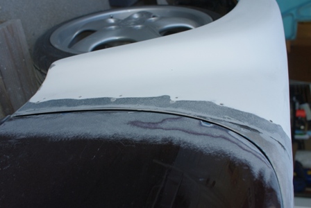

After smoothing down the edges there is very little filler work to do. My eye is healing well, maybe I can sneak in some work today! (IMG:style_emoticons/default/biggrin.gif)

raw1298   After smoothing down the edges there is very littl...   May 5 2011, 08:57 AM
charliew   I'm betting that will need to be filled all th...   May 5 2011, 02:55 PM
raw1298   I'm betting that will need to be filled all t...   May 5 2011, 06:00 PM
charliew   If I were trying to do this application, I would u...   May 6 2011, 03:32 PM
raw1298   If I were trying to do this application, I would ...   May 6 2011, 05:54 PM
