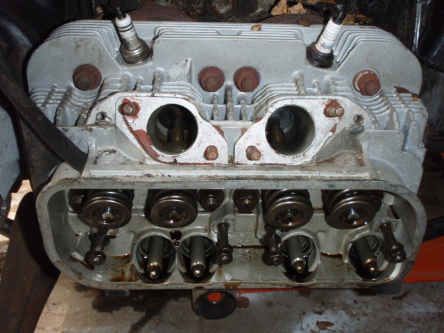

Looks like my intake seat has been hammerd inward just as you guys thought. (IMG:style_emoticons/default/sad.gif) Take a look. (IMG:style_emoticons/default/dry.gif)
the head is on its way back to rimco, it has only been 6k miles since it was done. they said they would fix it for me.
your thoughts are welcome.

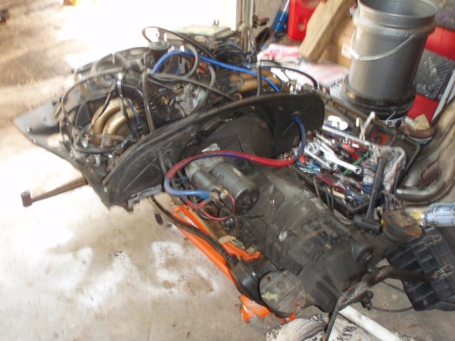

jsayre914   I started to drop the engine last night, but then ...   Apr 27 2011, 01:08 PM
Vacca Rabite   You got a lot done in an hour. All that usually ta...   Apr 27 2011, 01:52 PM
Eric_Shea   The valve seat you dropped. ;)   Apr 27 2011, 02:13 PM
jsayre914   The valve seat you dropped. ;) read carefully...   Apr 27 2011, 03:13 PM
r_towle   if you are planning to remove the heads...its obvi...   Apr 27 2011, 02:30 PM
r_towle   a seat that is getting beat into the head would al...   Apr 27 2011, 03:56 PM
jsayre914   i am pulling the head either tonight or tommorow d...   Apr 27 2011, 04:22 PM

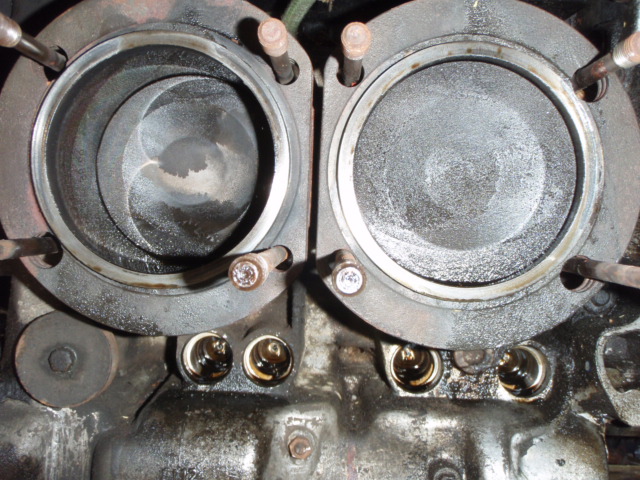

jsayre914   Looks like my intake seat has been hammerd inward ...   May 10 2011, 10:19 AM
jsayre914   the head Number 2 Number 1   May 10 2011, 10:20 AM
jsayre914   the seat the good side   May 10 2011, 10:22 AM
Vacca Rabite   I see head leaks too. You really won't like th...   May 10 2011, 10:33 AM
jsayre914   I see head leaks too. You really won't like t...   May 10 2011, 11:09 AM
type47   You really won't like the probable cause. :( ...   May 10 2011, 02:27 PM
jsayre914   I just checked the old thread.... YUP its the exac...   May 10 2011, 11:48 AM
