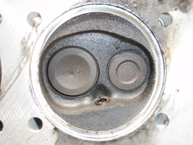

jsayre914   Looks like my intake seat has been hammerd inward ...   May 10 2011, 10:19 AM

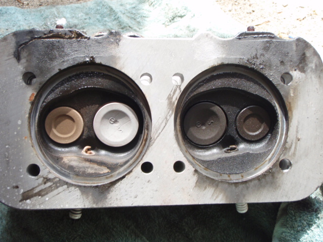

jsayre914   the head Number 2 Number 1   May 10 2011, 10:20 AM

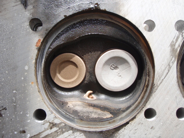

jsayre914   the seat the good side   May 10 2011, 10:22 AM
Vacca Rabite   I see head leaks too. You really won't like th...   May 10 2011, 10:33 AM
