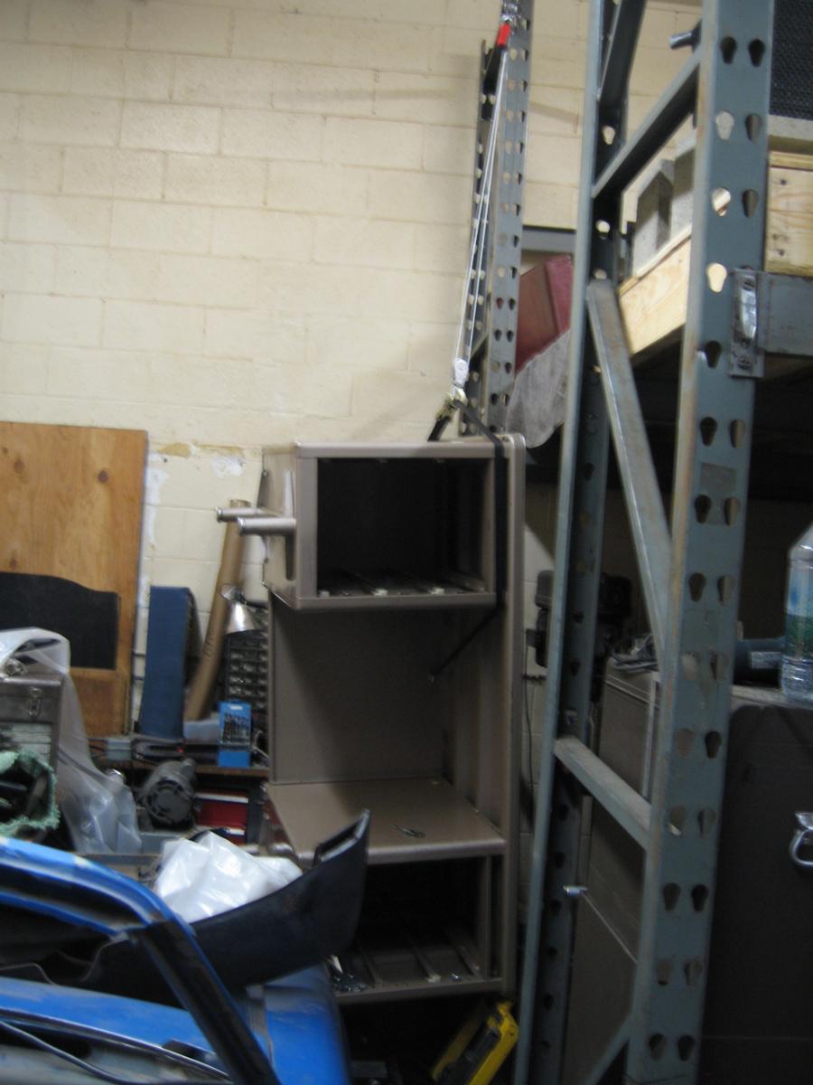

I got my mezzanine up, took me like a week. I got the 2 units for $80 a piece of craigslist. The wood was more, even, got 3/4" plywood. I've still got to paint the rest of the floor up thereg. Got to make room for the containment chamber so I can really get my mess on. (IMG:style_emoticons/default/happy11.gif)
(IMG:http://www.914world.com/bbs2/uploads_offsite/www.914club.com-11782-1305088954.3.jpg)
It's still a bit crowded in here, but it's not ridiculous like before. Organized some parts.

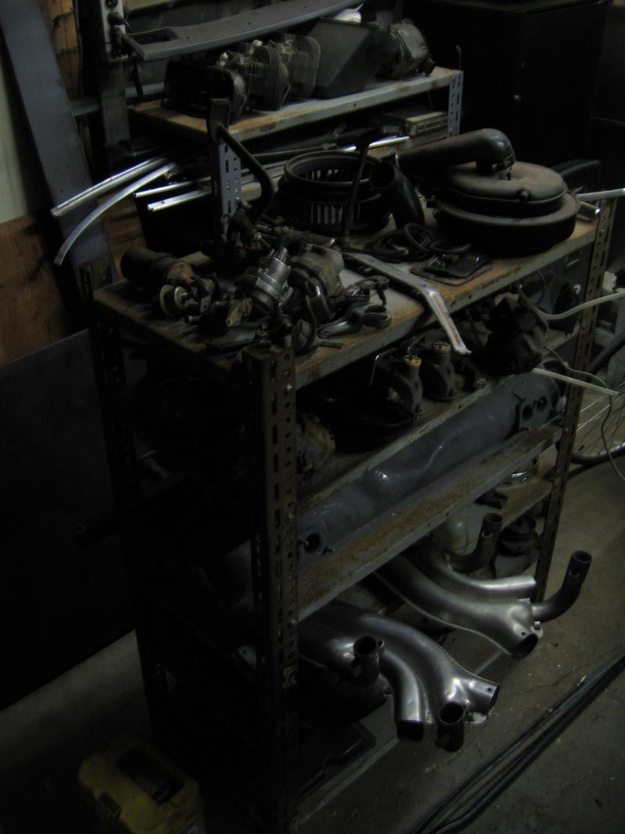

(IMG:http://www.914world.com/bbs2/uploads_offsite/www.914club.com-11782-1305088954.4.jpg)

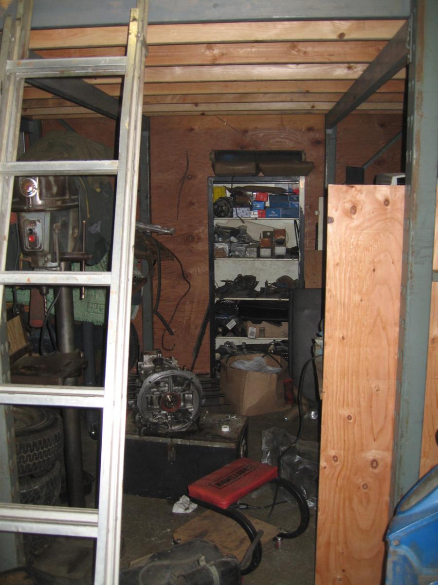

(IMG:http://www.914world.com/bbs2/uploads_offsite/www.914club.com-11782-1305088955.5.jpg)

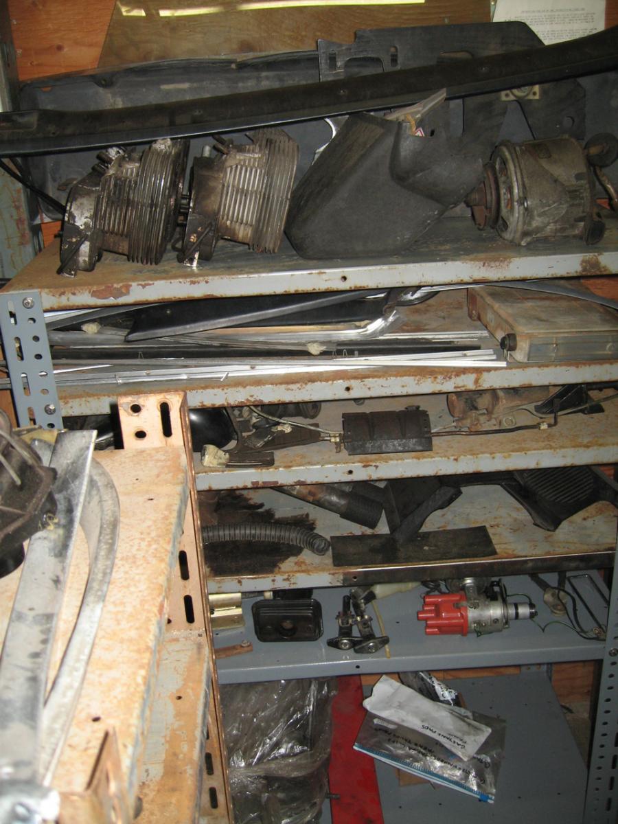

And some more parts, still need to organize a bit more.
(IMG:http://www.914world.com/bbs2/uploads_offsite/www.914club.com-11782-1305088955.6.jpg)

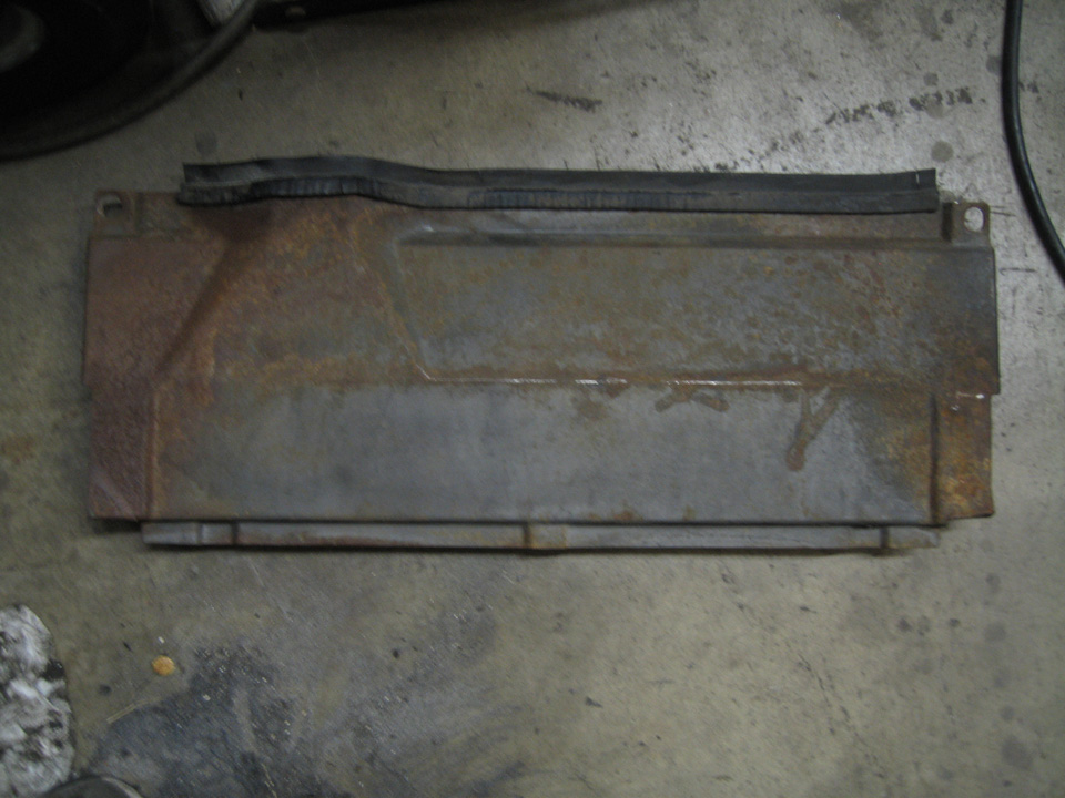

Oh, I found 1 of these. I had no idea there was anything supposed to be there, even! Is it called a splash pan?
(IMG:http://www.914world.com/bbs2/uploads_offsite/www.914club.com-11782-1305088955.7.jpg)

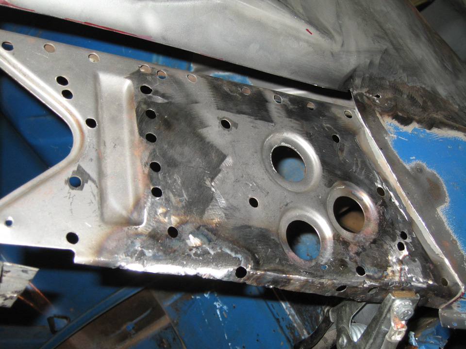

It took me forever to build up the inner inner long to get it ready for the lower inner fender well piece. I filled in like 25 holes on this thing, and built up the thin bottom section. This pic, it's not quite done. I should be putting the piece on soon so I'll have better pics then.
(IMG:http://www.914world.com/bbs2/uploads_offsite/www.914club.com-11782-1305088956.8.jpg)

saigon71   Your craftsmanship is awesome! :beer2: Our c...   Dec 11 2011, 07:32 AM
sixnotfour   Spider bite , nasty, get well. Awesome splice wo...   Dec 11 2011, 08:23 AM
BarberDave   :trophy: WOW, What talent !!! ...   Dec 11 2011, 09:00 AM
nathansnathan   Thanks, guys for all the compliments/ encouragemen...   Dec 11 2011, 02:14 PM
SirAndy   The way restoration design does the hell hole repa...   Dec 11 2011, 02:27 PM
