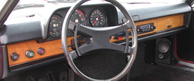

Byron - the big difference was adding fresh air vents at each end, with corresponding shortening of the glovebox/door & shifting inboard of the switches on the far left. So the top & knee pads differ accordingly.
Here's my buddy's 71 914/4 (that's a dealer supplied rosewood dash face option since sold new) without the side vents -
... continued next post ....

What changes on the top pad? -I've got the late dash with the vents in my 72. I'm a bit worried now as I found an uncracked top pad relatively cheap and I'm not sure what year it was out of. I'll have to take it out of the box and compare later.

SLITS   Ashtray is in a slightly different location on ear...   May 12 2011, 01:22 PM

Garold Shaffer   Best way to tell is mesaure the width of the inden...   May 13 2011, 05:28 AM

nathansnathan   I measured mine. I'm lucky they're both la...   May 31 2011, 06:28 AM
racerbvd   Thanks, so 13.5 across in the glove box area makes...   Jun 2 2011, 06:57 PM
Garold Shaffer   I would say yes.   Jun 2 2011, 07:54 PM
racerbvd   So this is correct then...   Jun 2 2011, 09:09 PM
