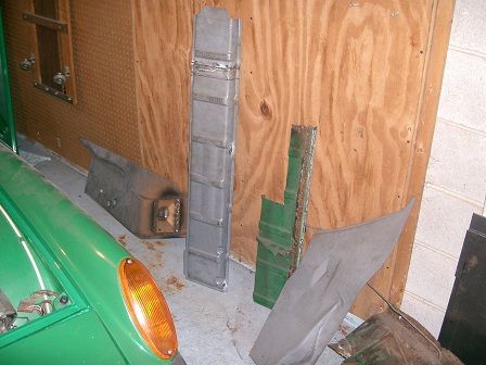

Fabrication - continued:

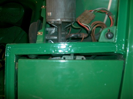

Finally finished the front hood channel. One section was fabricated & replaced. All rust was treated with Ospho, two coats of Rust Bullet then two coats of brushed on acrylic enamel:

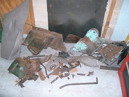

My virtual junkyard:

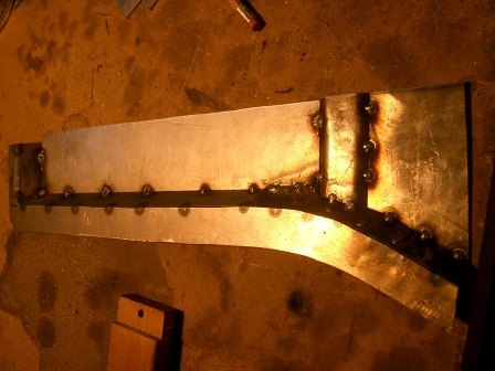

saigon71   While waiting on the inner "ply" for the...   May 15 2011, 06:32 PM
saigon71   Cutting - continued: Luckily, it looks like the ...   May 15 2011, 06:42 PM

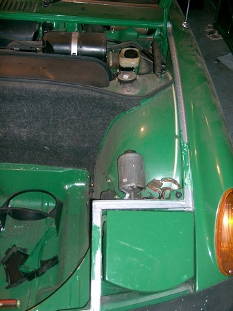

saigon71   Fabrication - continued: Finally finished the fr...   May 15 2011, 06:49 PM
