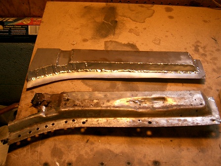

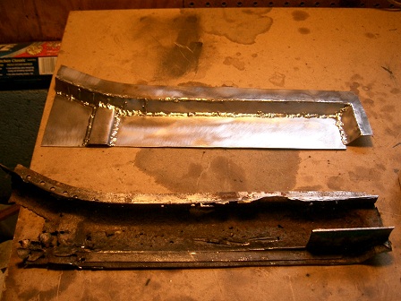

Finally got my new inner long welded in with doubler plates on all seams. Verified the incline of the new long with an incline gauge (with the car level) following Jeff Hails build thread. Door operates well! Entire inner long has been coated with rust encapsulator.
Still have a long way to go but I am hoping that this was the toughest part.
Thanks to Scotty B, Jeff Hail, and everyone else who has posted a build thread on this topic. I have read all of them & learned a lot. (IMG:style_emoticons/default/beerchug.gif)

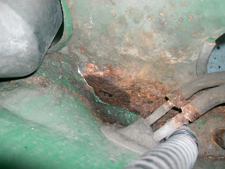

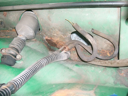

Zipped up the seams on the replacement floorpan piece today, the piece is now in the crawl space (paint room) drying, after getting sprayed with primer:
Pulled out the gas tank, following the Pelican article...was not surprised to find more rust under the tank:
