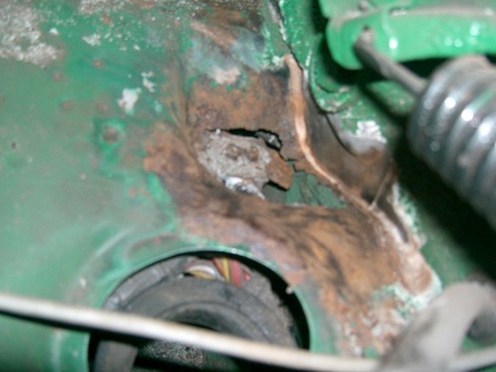

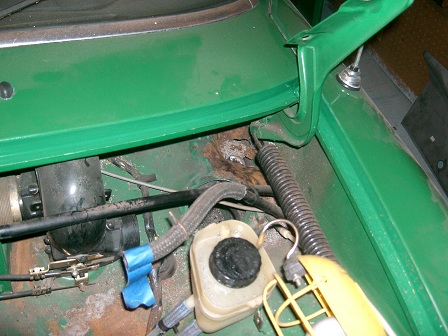

Found another large spot of rust where the front trunk latch cable attaches under the dash. The mounting point is completely gone and all that remains is a hole. My question is...what would cause this area to rust out so bad? Fender to cowl seals?

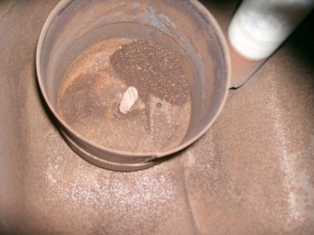

Finally, my gas tank is rusty inside. How rusty is too rusty? Can I dump all the rust out and expect this to not get much worse if I keep gas in the tank? My goal here is a reliable daily driver...am I asking for trouble if I don't re-seal this tank?

saigon71   Found another large spot of rust where the front t...   May 17 2011, 07:23 PM
mepstein   Found another large spot of rust where the front ...   May 17 2011, 07:53 PM

saigon71   Dropped the rusty fuel tank off at the radiator sh...   May 23 2011, 07:27 PM
saigon71   The area where the front hood release was rusted s...   May 23 2011, 07:48 PM

saigon71   Picked up my gas tank from the radiator shop last ...   Jun 5 2011, 07:06 AM

saigon71   Put the tank back together with a new Foley fuel s...   Jun 12 2011, 09:26 AM

saigon71   Finished up the repair of the front hood cable att...   Jun 22 2011, 03:37 PM
