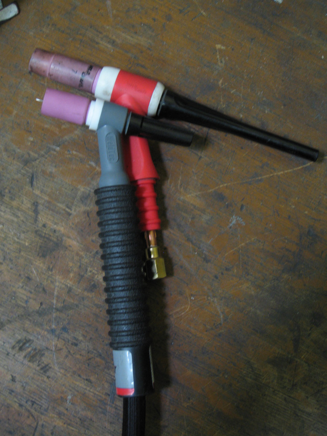

I had been waiting the last 10 days for the parts from cyberweld, some mixup at my mailbox. They do have hookas for sale right in the place, the pack & ship.
Finally got the back caps, the small ones they sent me were wrong, were for the 17 torch instead of the 9 so pictured are the medium. Both of those are #7 cups.
(IMG:http://www.914world.com/bbs2/uploads_offsite/www.914club.com-11782-1305947534.1.jpg)

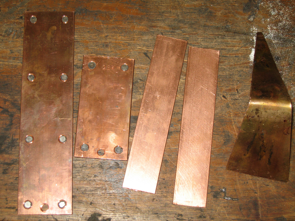

I hooked up with some weld backing options also, these from Eastwood. The triangle is my favorite so far, used it a lot for the inner inner long.
(IMG:http://www.914world.com/bbs2/uploads_offsite/www.914club.com-11782-1305947534.2.jpg)

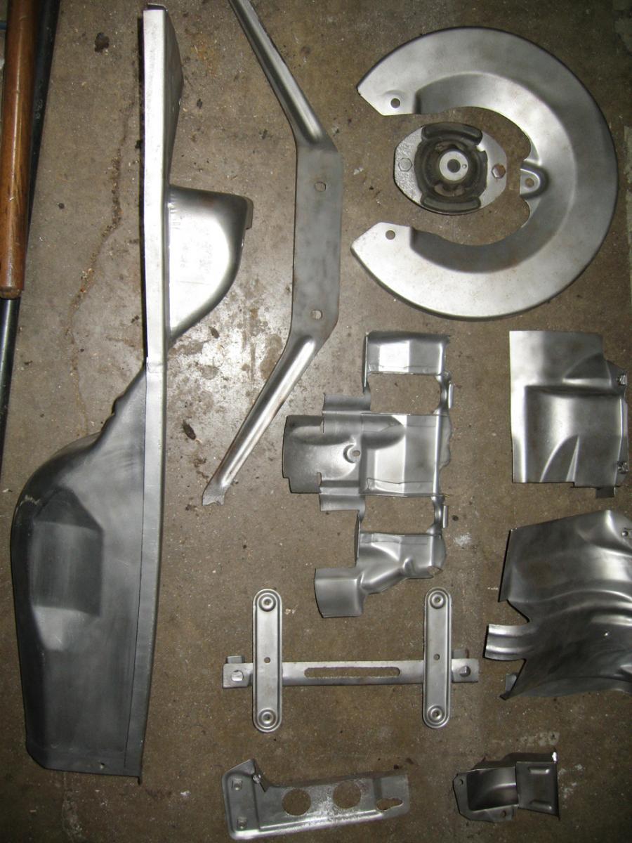

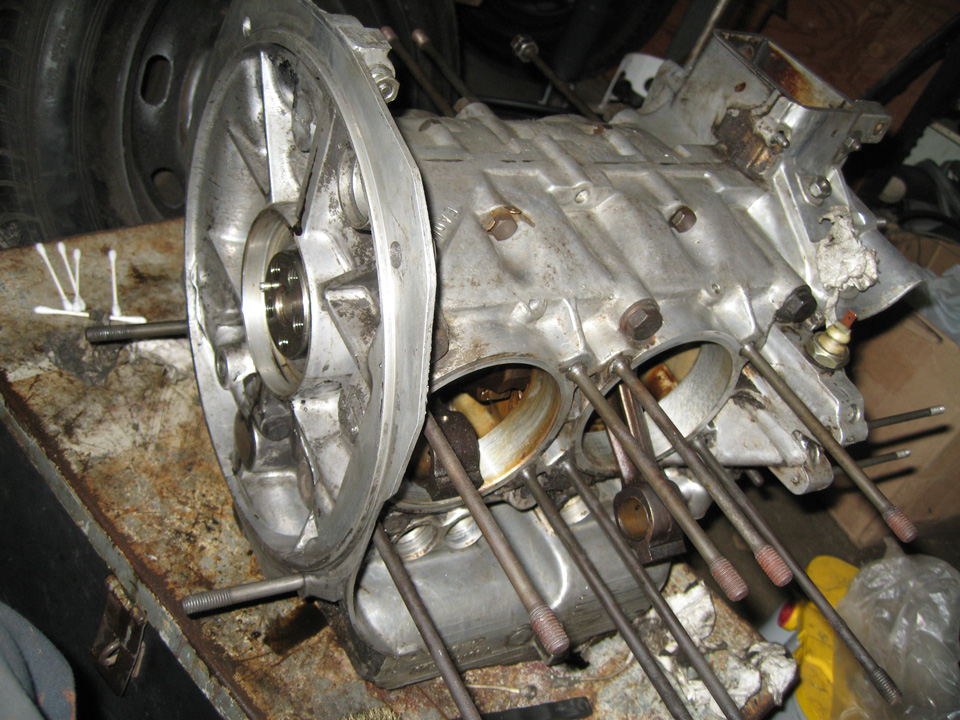

During the wait though to do more welding, I've been detailing the outside of my engine case. Various methods employed have included a bit of acetone with lots of cotton swabs and paper towels, a bit of paint thinner and a brush, simple green some.
(IMG:http://www.914world.com/bbs2/uploads_offsite/www.914club.com-11782-1305947535.3.jpg)

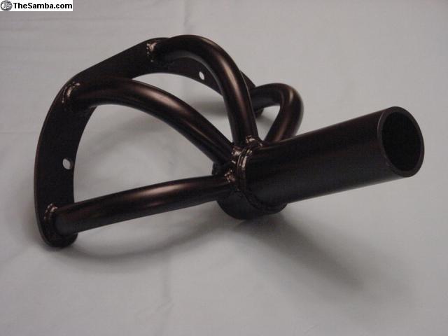

Still coming along. I won't be able to finish until I put it on the stand and that I won't bother with until I've modified it. I've purchased this yoke:
(IMG:http://www.914world.com/bbs2/uploads_offsite/images.thesamba.com-11782-1305947535.4.jpg)

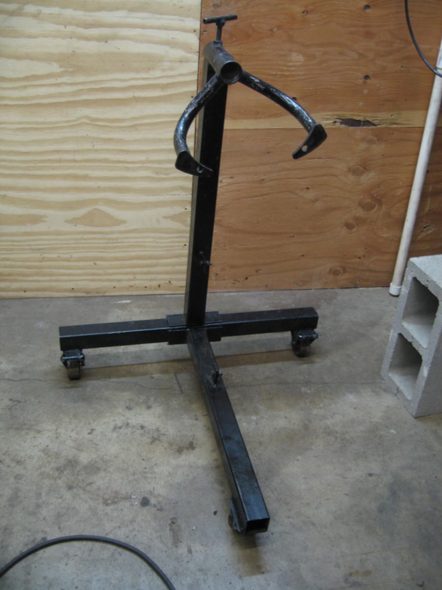

I have 2 of these coming.
(IMG:http://www.914world.com/bbs2/uploads_offsite/www.mcmaster.com-11782-1305947536.5.jpg)
I need to go to Industrial metals to get a cross beam for the front of this fan shroud murderer.
(IMG:http://www.914world.com/bbs2/uploads_offsite/www.914club.com-11782-1305947536.6.jpg)
Besides that, I've been blasting a piece or so of the tin each day.
(IMG:http://www.914world.com/bbs2/uploads_offsite/www.914club.com-11782-1305947537.7.jpg)
It does take awhile, the compressor is always running. (IMG:style_emoticons/default/smash.gif)
