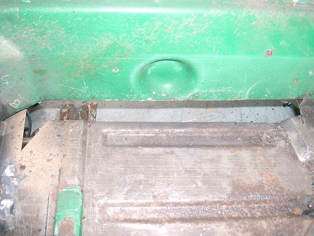

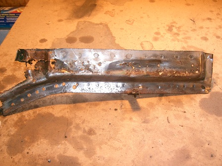

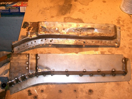

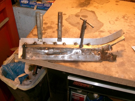

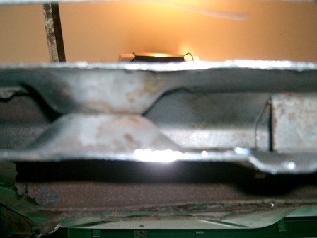

Cutting - continued:
Luckily, it looks like the rust only crept about an inch or so up into the firewall...this shot is looking between inner & outer firewall.
The damaged area:
Short on money, but long on time & sheet metal, I decided to try to fabricate a replacement piece...started by cutting the bottom curved piece at the base of the firewall and went from there. The most difficult part for me was the compound bend, where I had to cut slits to get the right contour, then fill with weld. I left it a little long in all dimensions, so I could trim it as needed for the final fit. Still need to weld all seams on this, but I am pleased with how it is shaping up:
