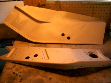

Restoration Design shipped me the inner ply for the wheelhouse section last week:

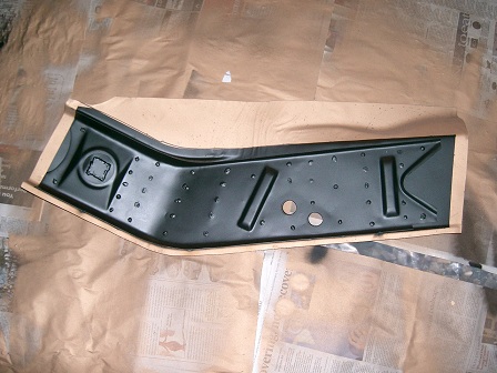

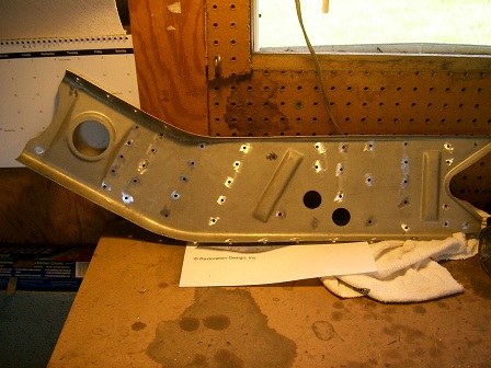

Drilled holes for the rosette welds:
Fabricated a cover plate for inside of the jack post & welded it on. Sprayed both parts with weld thru primer:

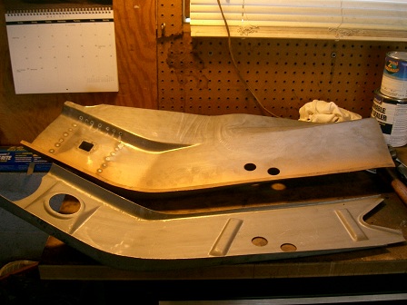

Two plies welded together:

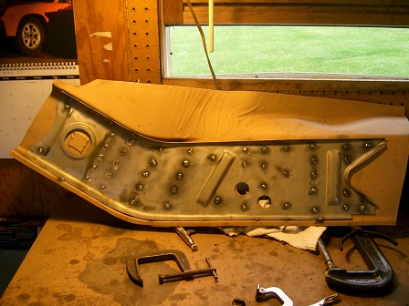

Finished product...weld thru primer on the seams, rust encapsulator everywhere else. I hope to start welding this in tomorrow:
