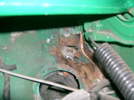

The area where the front hood release was rusted so bad, the hood release was just hanging there under the dash, supported only by the cable tube:

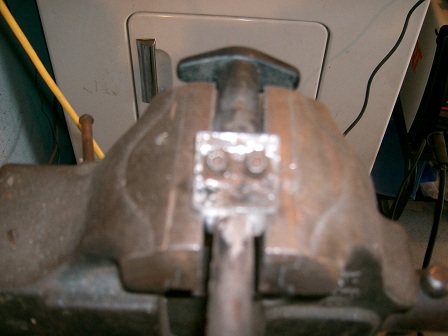

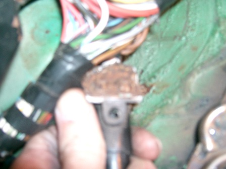

The cable assembly had to be removed to gain access to the area. Plus, the bolts were a rusty mess. Vice grips were the only way to break them loose:

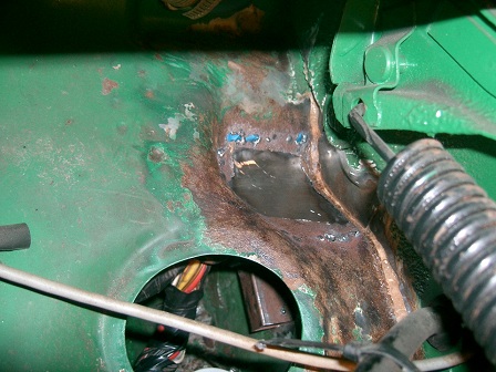

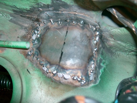

Welding upside down really sucks! (IMG:style_emoticons/default/mad.gif) I had better access to this from under the dash. After hitting everything with a dremmel tool wire wheel attachment, I bent up a doubler plate out of 20ga sheet metal and tacked it on with my body folded up under the dash. I had some burn through on some of the weaker metal so I had to rule out completely welding the seams, but was able to get it tacked in place. Raked my spine on the body braces twice getting out of the car - ouch.
