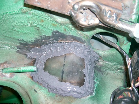

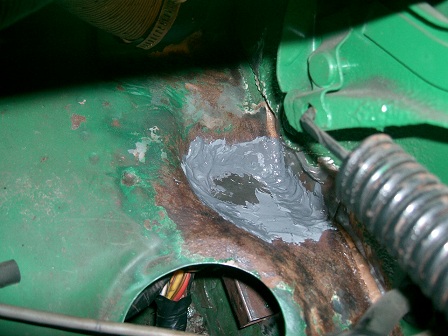

With the burn thru problem and the fact that it was such a PITA working in this tight space, I opted use a liberal application of JB Weld on both top & bottom to fill between the tack welds. It is certainly not my best work, but I believe it will be strong and functional. This area will be inspected once in a while after the car is on the road:
From above:
From below:
