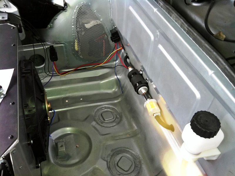

Front trunk with Walbro fuel pump installed & remote reservoir for hydraulic clutch

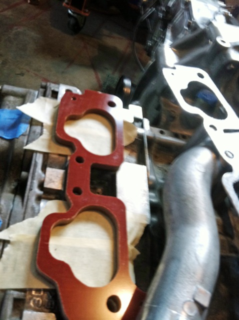

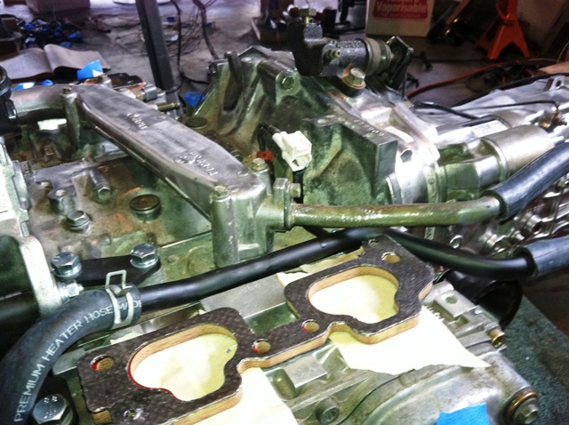

Phenolic spacer ordered from Grimmspeed
Modified heater downpipe to the water pump
