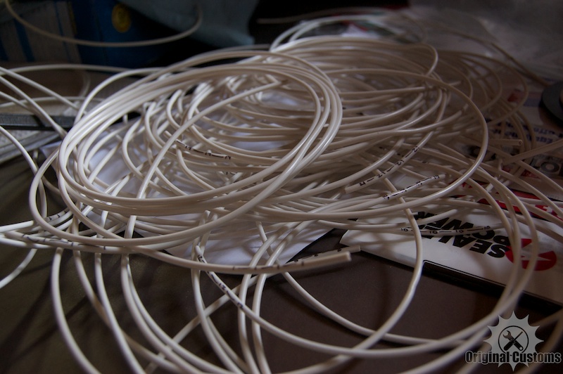

Hard to believe this pile of wire is close to becoming a wiring harness...

ConeDodger   Hard to believe this pile of wire is close to beco...   May 30 2011, 05:59 PM
