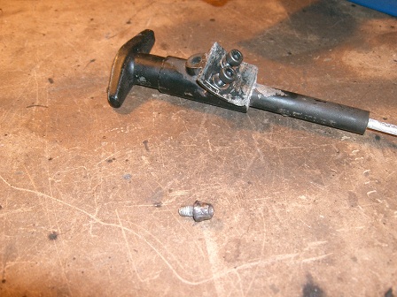

Picked up metric allen bolts at Home Depot for the front hood latch attachment point:

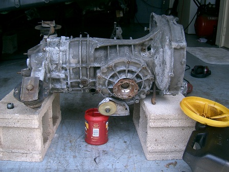

After reading a thread on the world about proper cleaning of a transmission, I realized that I never plugged the overflow when pressure washing mine at the local car wash last year. I got worried about water in there, so I drained the old fluid out...did not see any water but the magnetic drain plug was chock full of filings. Tranny was re-filled with proper fluid and put back in the shed:

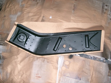

2nd ply of the outer wheelhouse was welded in last week, prepped and ready to be installed:

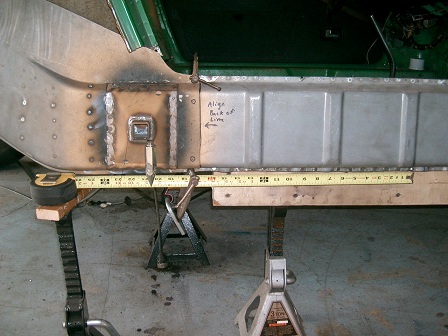

I measured the distance from the middle screw on the original drivers side long to a plumb bob off the front of the jack post. Matched the 20.5" measurement on the passenger side for proper fore-aft fit:
