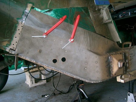

Finally got my new inner long welded in with doubler plates on all seams. Verified the incline of the new long with an incline gauge (with the car level) following Jeff Hails build thread. Door operates well! Entire inner long has been coated with rust encapsulator.

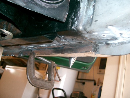

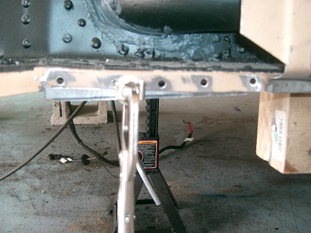

Everything lined up pretty well, except for one section at the rear of the inner long. This area was rebuilt 6" at a time hand formed in a vice. The last section seemed to twist up in the rear when I was welding it in. However, it lined up well with the inner long section previously welded in. All things considered, I decided to add a small extension piece to the bottom so the rosette welds would line up properly:
Final fitment outside:
Final fitment inside:

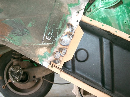

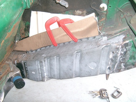

Fabricated & installed a doubler plate for the rear...had to modify it several times to clear the inner ply of the outer wheelhouse:
