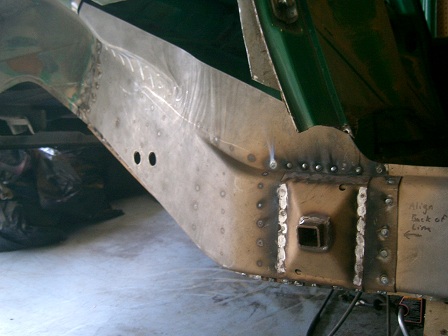

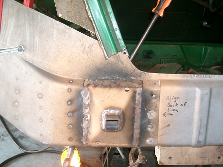

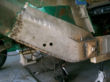

Finally got my new inner long welded in with doubler plates on all seams. Verified the incline of the new long with an incline gauge (with the car level) following Jeff Hails build thread. Door operates well! Entire inner long has been coated with rust encapsulator.
Still have a long way to go but I am hoping that this was the toughest part.

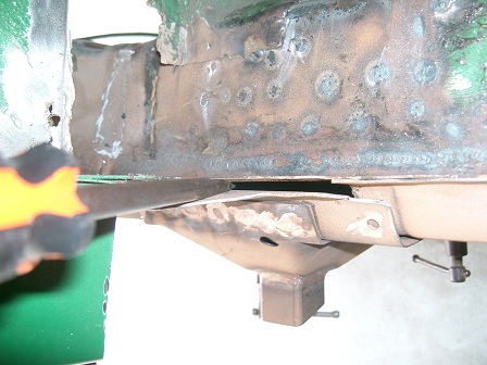

DAMNIT!!! After filling about 7 rosettes, I realized I forgot to drill the holes directly above the jack post support. Improvised with a large screwdriver wedged in to get enough clearance to drill new holes. Snuck a dremmel tool in to deburr the backside of the holes:

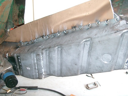

I found the fitment of this piece to be challenging. It was clamped on and removed about 25 times before finally filling the first rosette. Probably due to the "learn as you go method." (IMG:style_emoticons/default/sad.gif) Overall, I am pleased with how it has turned out so for. The heat started to get to me, so it was time for a cold beer and cold A/C. Will zip up the seams this week and should get the gas tank back:
