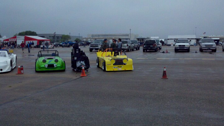

Per SCCA rules, E Mods cannot use wings......XP cars can.....go figure.
As a result when E Mods gather (such as the Lincoln NT here) there iare a fairly narrow range of spoilers attending. All they have in common is they are built to the max of the rules (for the most part).
The Jeep is new. (IMG:style_emoticons/default/biggrin.gif)
