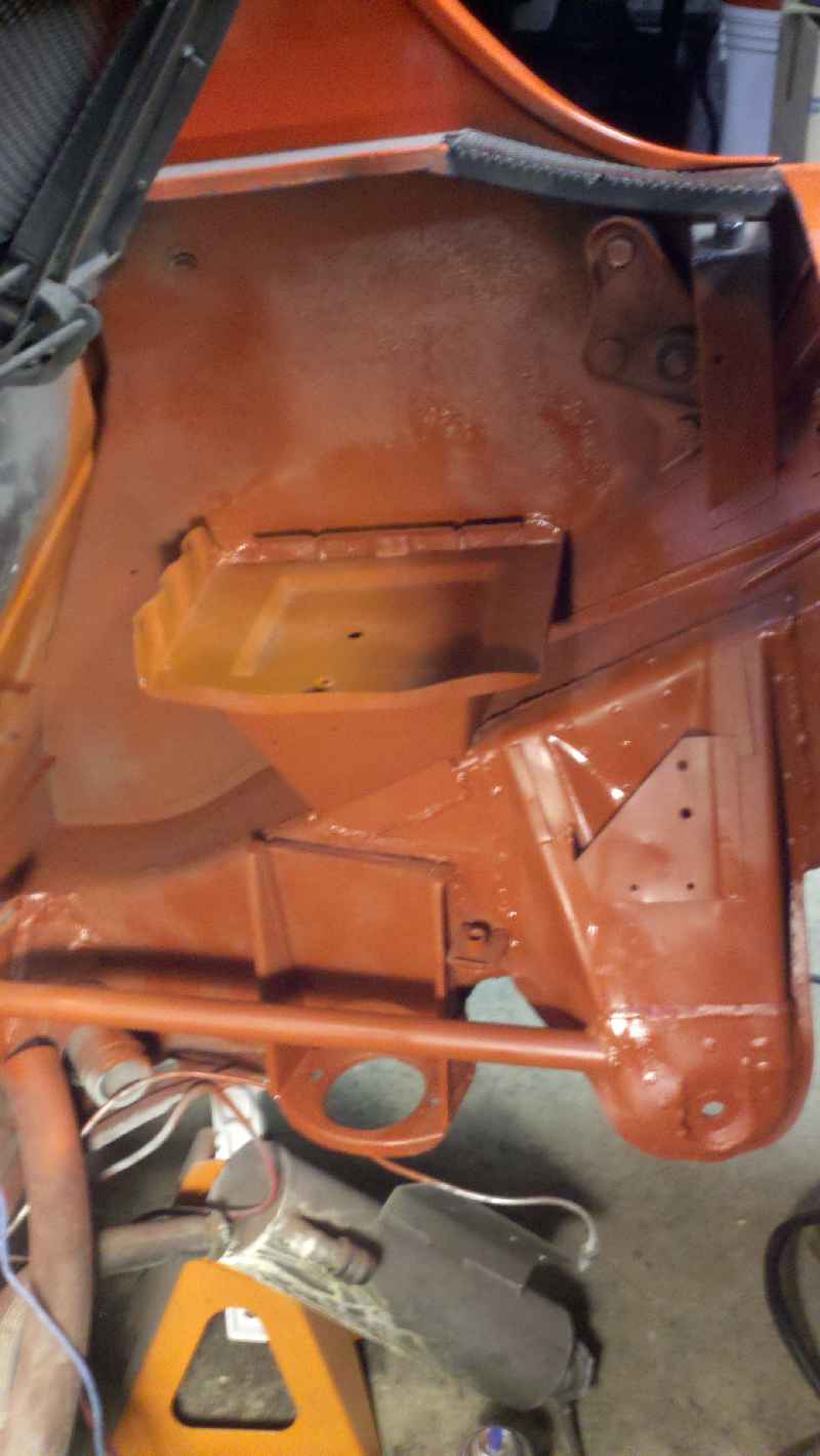

So I notice my passenger rear wheel camber was way off. That side of the car was sagging a little bit. I figured something came loose. I jack up that side of my car (IMG:style_emoticons/default/headbang.gif) (IMG:style_emoticons/default/headbang.gif) (IMG:style_emoticons/default/headbang.gif) (IMG:style_emoticons/default/headbang.gif) (IMG:style_emoticons/default/headbang.gif) (IMG:style_emoticons/default/headbang.gif) (IMG:style_emoticons/default/headbang.gif) (IMG:style_emoticons/default/headbang.gif) (IMG:style_emoticons/default/headbang.gif) (IMG:style_emoticons/default/headbang.gif)
Take a look at my suspension ear (IMG:style_emoticons/default/hissyfit.gif) (IMG:style_emoticons/default/hissyfit.gif) (IMG:style_emoticons/default/hissyfit.gif)

Thanks to Ian my suspension ear is all finished. We added the CFR reinforcement to both ears. Then added a plate on the firewall. Then cut & welded a bar from the ear to the firewall. Really turned out nice.
Ian stayed until midnight welding it up for me last night. I know he had a busy week & I really appreciatted all the welding he has done for me. Next time he's down I am going to get some welding lessons too. You rock Ian (IMG:style_emoticons/default/aktion035.gif)
