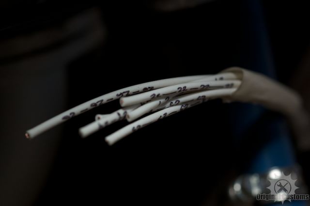

OMG! Looks like McMark hired munchkin wire writers to keep the wires organized!

ConeDodger   Hard to believe this pile of wire is close to beco...   May 30 2011, 05:59 PM
Elliot Cannon   Rob, I saw your engine at the McSwap meet. It loo...   May 30 2011, 06:06 PM
ConeDodger   Rob, I saw your engine at the McSwap meet. It lo...   May 30 2011, 06:47 PM
McMark   Harness mockup goodness.... :drooley:   May 30 2011, 07:39 PM
ConeDodger   OMG! Looks like McMark hired munchkin wire wri...   Jun 3 2011, 09:09 PM
r_towle   they DO make wires with different colors.... R   Jun 3 2011, 09:30 PM
ConeDodger   they DO make wires with different colors.... R ...   Jun 3 2011, 10:12 PM
