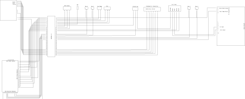

they DO make wires with different colors....
R

QUOTE(r_towle @ Jun 3 2011, 07:30 PM) *
R
True enough... but one color of wire with numbers written on them that correspond to this (see below) is cheaper and very useful...

McMark   Got the wiring diagram drawn up yesterday. There ...   Apr 28 2011, 10:27 AM
ConeDodger   Sorry Mark. Think of yourself as a pioneer. :) Fo...   Apr 28 2011, 11:02 AM
McMark   True. I usually remember to include that caveat. ...   Apr 28 2011, 11:33 AM
