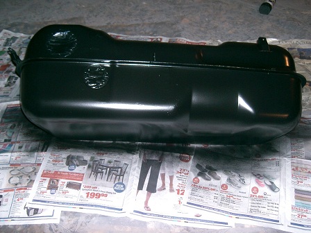

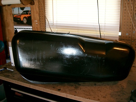

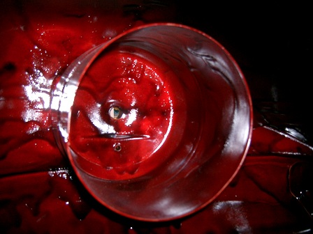

Picked up my gas tank from the radiator shop last week. Cleaned, patched, sealed, pressure tested, primed and painted for $160. The only problem is that they painted it in gloss black. So I spent a few hours sanding it down and re-painted it in semi-gloss black. The shop used "Red Coat" as the sealer:

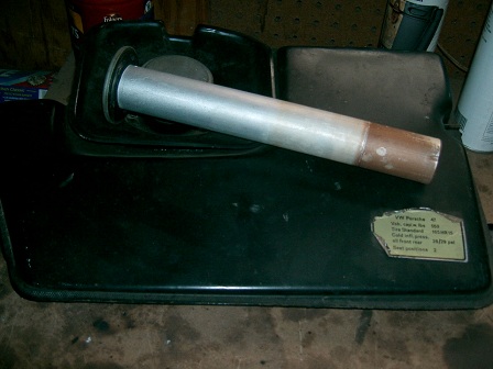

saigon71   Put the tank back together with a new Foley fuel s...   Jun 12 2011, 09:26 AM
