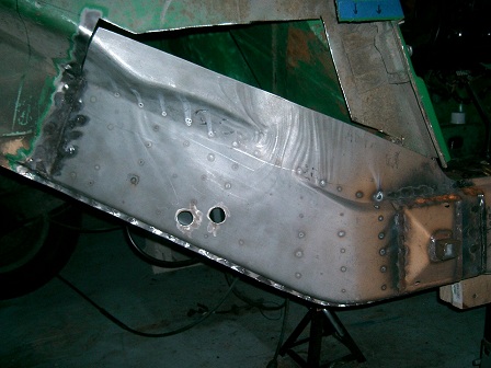

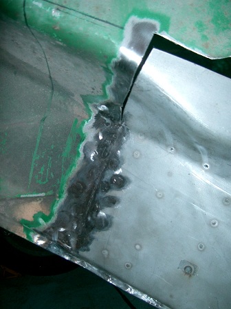

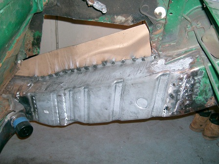

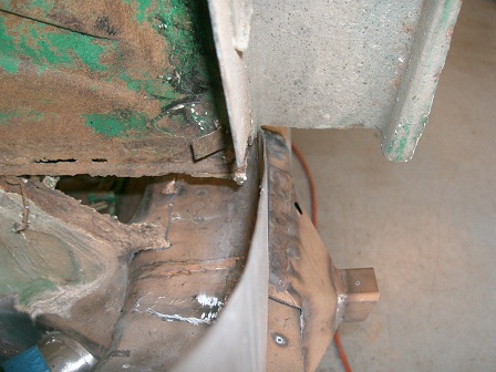

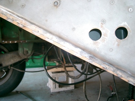

Welded up the seams on the outer wheelhouse, then started grinding...
The inner long needed some trimming at the bottom for a flush fit. A cutoff wheel made quick work of this:
"Finished" job - outer:
"Finished" job - inner:
Closeup of rear seam:
There remains a slight (about 3/16") alignment issue with the upper portion of the lower wheelhouse under the rear door jamb. I should be able to get this aligned with a hammer and block of wood.
