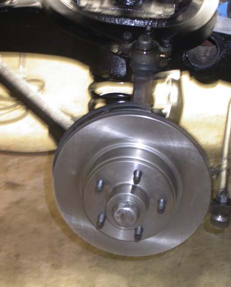

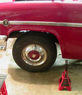

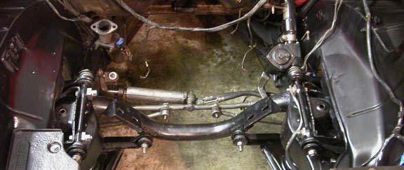

Lots of tasks have been added and crossed off the board and today Loocy came off jackstands for the first time in way too many years!
The front suspension has newly powdercoated control arms with new ball joints and bushings. A rebuilt factory power steering rack has also been retro-fitted.
With the steering and handling enhancements comes a disc brake conversion.
I put new air in the tires and tried to mount them to the new hubs, only to discover that the center hole on the '54 wheels was too small for the '75 Granada hubs. (IMG:style_emoticons/default/headbang.gif) Made a call to the neighborhood boneyard for some later model wheels and they set me up. When they asked what condition the tires needed to be I said, "hold air." Ultimately a set of wide white radials will be ordered.
It felt great to slide those jackstands out and lower the car to the ground. Tomorrow she leaves the garage for the shop where the rebuilt engine and tranny will be installed.
