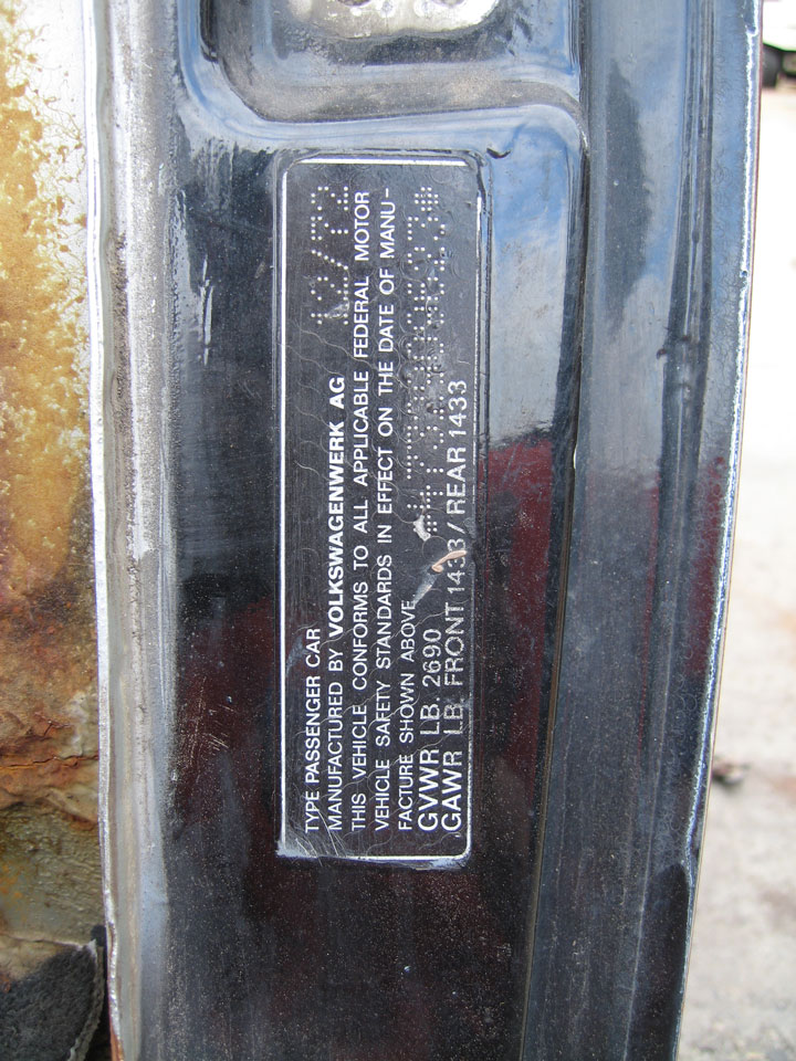

Chassis # 174932
-Meaning the chassis was built the 17th week of the year 1972 (I think it is the 17th week with a Monday the way they count it), the 4th day of that week, Thursday April 27th, 1972. -I thought it was 4/20 but I must concede it was probably a week later, the chassis production.
(IMG:http://www.914world.com/bbs2/uploads/post-179-1307065668.jpg)
It is odd, though, the dash doesn't match.
1729556 vs 1749532 which is on the Karmann plate and the trunk.
It would be from just 2 days earlier, but then I was thinking, if it was from another car, it could theoretically be from a 73 or a 74 car, too. It seems like it is original, though, as peple always bodge everything and it was fairly unmolested, the wiring, and hardware of the dash.

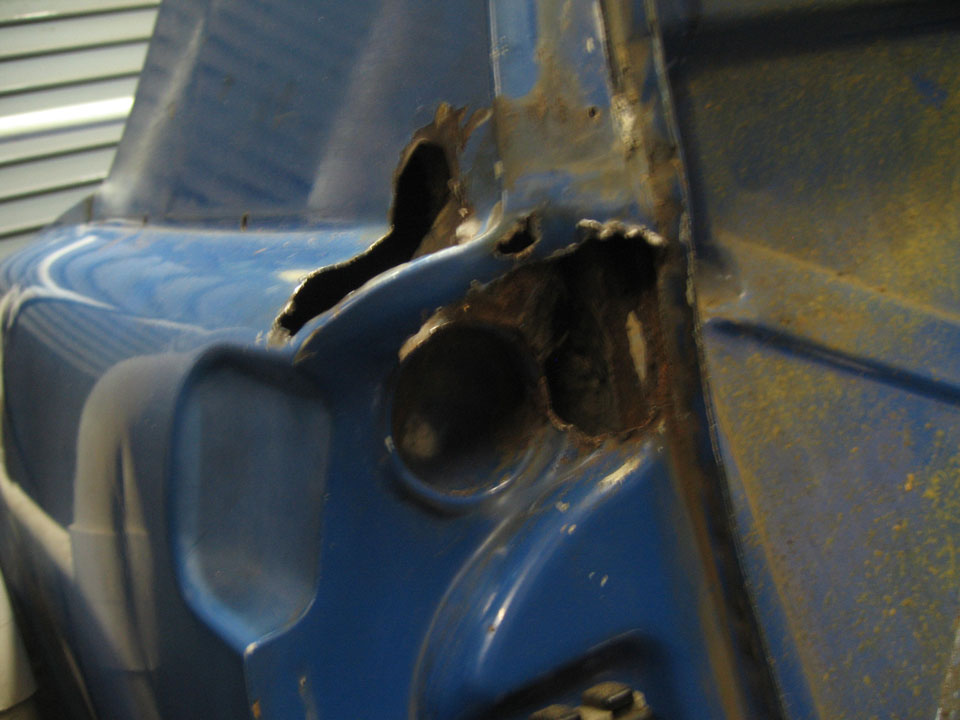

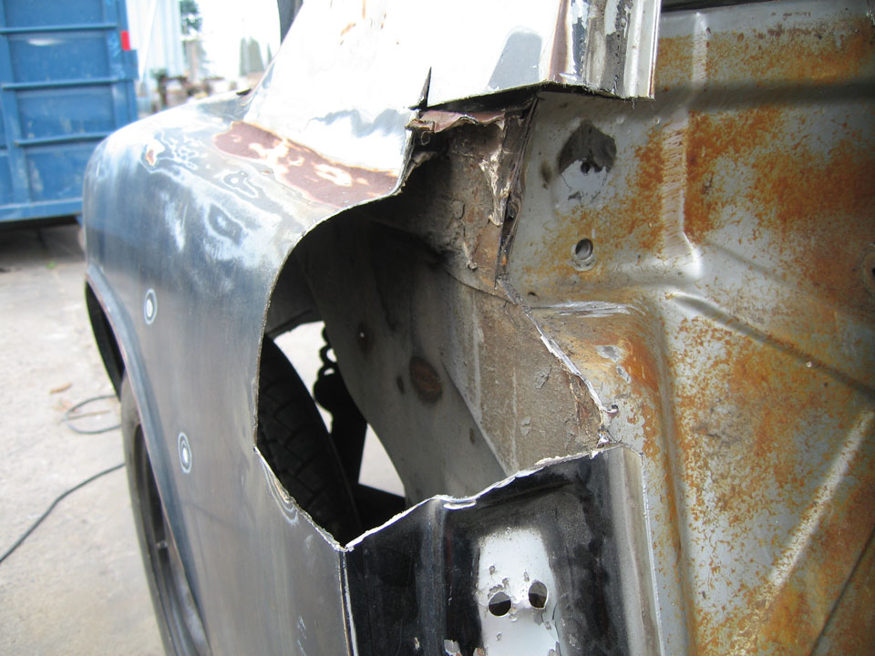

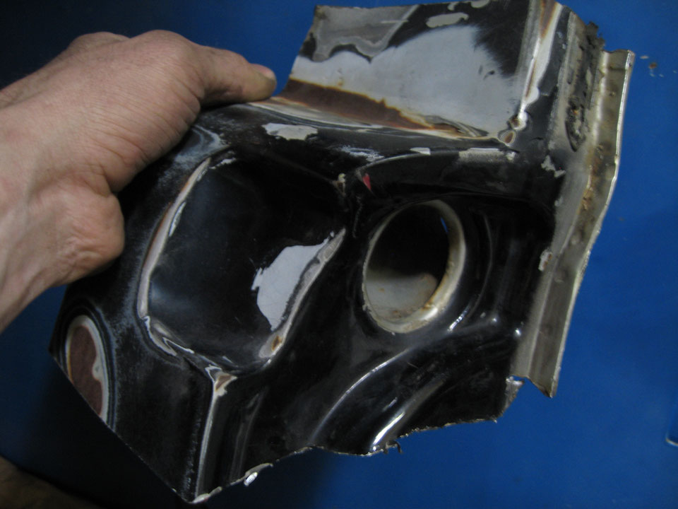

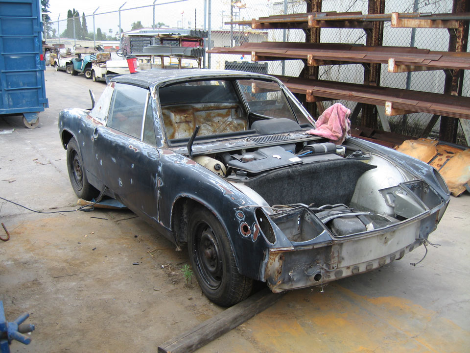

I met up with David again, I'd been thinking about the fresh air vents on his roller ever since I'd seen a week or 2 before getting the Mahles. I got some pics this time.
(IMG:http://www.914world.com/bbs2/uploads_offsite/www.914club.com-11782-1307842265.1.jpg)
(IMG:http://www.914world.com/bbs2/uploads_offsite/www.914club.com-11782-1307842266.2.jpg)
The car is pretty crusty at the longs and jack point is floating in the rocker, lower firewall is bad, and floors. She was well done, and so with the fresh air vents being very good compared to mine
(IMG:http://www.914world.com/bbs2/uploads_offsite/www.914club.com-11782-1291591584.2.jpg)
Rather barbaric, I used a .40" cutting wheel on my 4 1/2 inch angle grinder.
(IMG:http://www.914world.com/bbs2/uploads_offsite/www.914club.com-11782-1307842266.3.jpg)
(IMG:http://www.914world.com/bbs2/uploads_offsite/www.914club.com-11782-1307842266.4.jpg)
I got the seam sealers all out with the heat gun and scraping screw driver, some rust in there but solid. I've started blasting and it's looking great.
(IMG:http://www.914world.com/bbs2/uploads_offsite/www.914club.com-11782-1307842267.5.jpg)
Will get a picture of after blasting and how I'm gonna install later.
