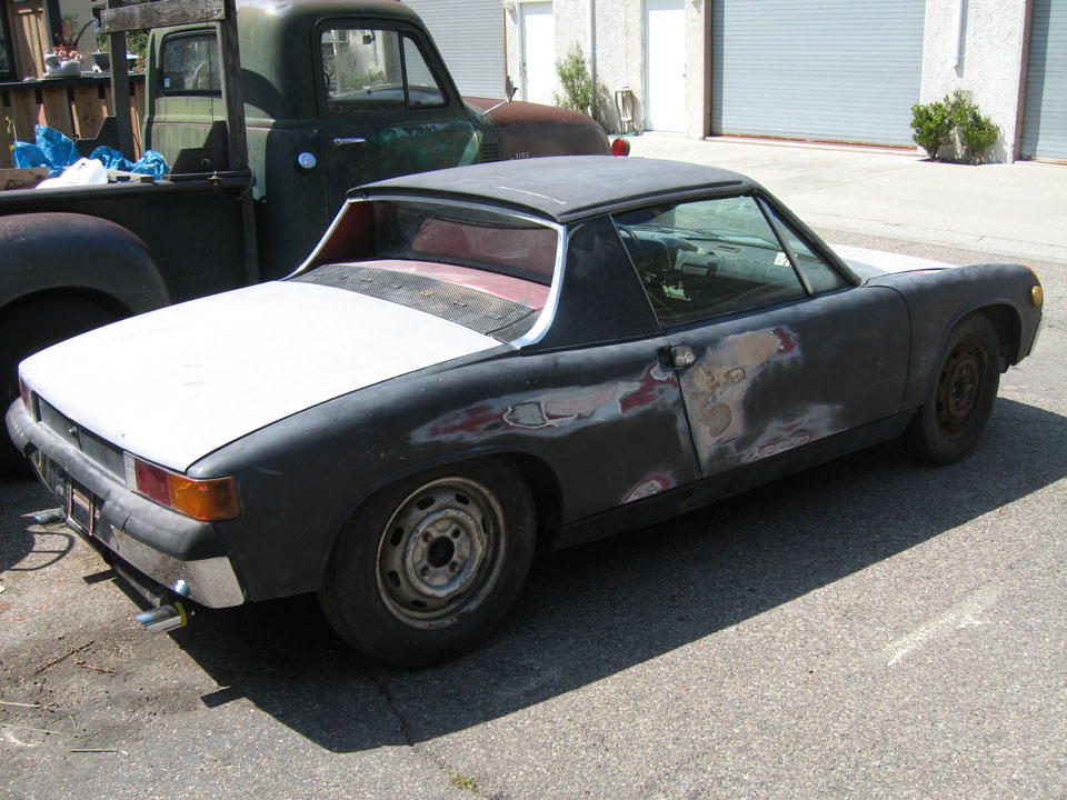

The car was very original, but quite trashed when I bought it. It's a 49 state car, purchased in Colorado judging by the sticker that was on the back opposite the badge, Bob Hagestad Dealerhip. I don't have a picture of that unfortunately... Both bumpers had 1975 UCLA parking permit stickers.
It is an appearance group car, tan square weave, late enough to get 2 real tan basket weave seats. Original adriatic blue paint, no repaints. The snowplow early rear valence. It has the original red heater lever pull which I don't see very much. Everything was there without having been hacked/modified (besides the door panels). Unmodified but fairly trashed.
Chassis # 174932
-Meaning the chassis was built the 17th week of the year 1972 (I think it is the 17th week with a Monday the way they count it), the 4th day of that week, Thursday April 27th, 1972. -I thought it was 4/20 but I must concede it was probably a week later, the chassis production.

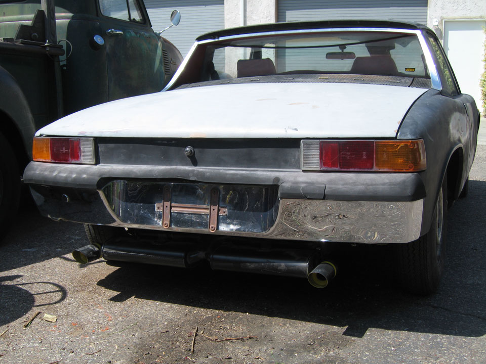

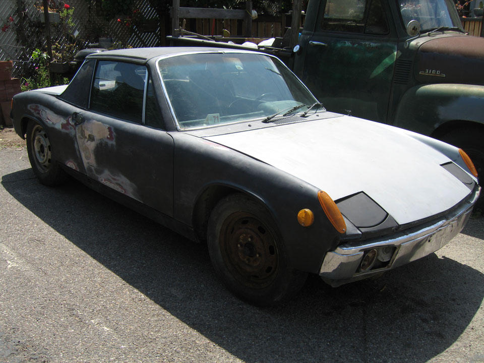

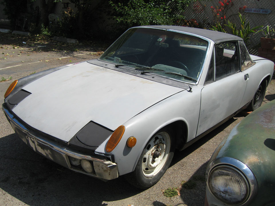

taking it to the next level, another car has come to me. (IMG:style_emoticons/default/beer.gif)
(IMG:http://www.914world.com/bbs2/uploads_offsite/www.914club.com-11782-1307844936.1.jpg)
(IMG:http://www.914world.com/bbs2/uploads_offsite/www.914club.com-11782-1307844937.2.jpg)
(IMG:http://www.914world.com/bbs2/uploads_offsite/www.914club.com-11782-1307844937.3.jpg)
(IMG:http://www.914world.com/bbs2/uploads_offsite/www.914club.com-11782-1307844937.4.jpg)
It's funny, I realized after contacting the po that it was a guy I got a $2 door handle off of the first week I had my 914, Paul, who works at Rancho Transmission in Santa Ana. He is exactly 16 miles from me and I got it towed here this morning much more affordably than the first one, thankfully, though we did have to wait it seemed 2 hours for the guy to come on his 'day off'. Good stuff though to talk shop with a guy that knows about these things, or Volkswagens anyway.

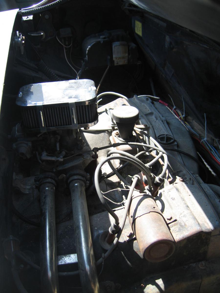

Tuning was so so, probably would have idled if it got warm. It runs, I should add. The carb is, he told me, a real one out of an actual Pinto. The valves sound good though. I will have to do a compression check. Thinking I may get it rolling with that engine while I put mine together.
(IMG:http://www.914world.com/bbs2/uploads_offsite/www.914club.com-11782-1307845285.1.jpg)
Body is pretty crusty on this one, too, mostly down low though where mine is worse above, well except the hell hole, this one is the worse, the 420 car seems solid in comparison.
